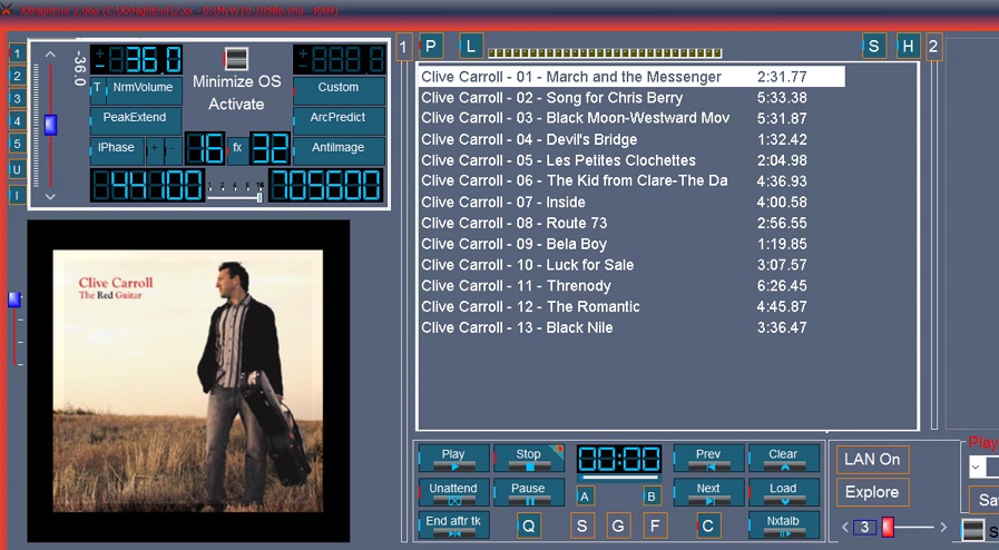

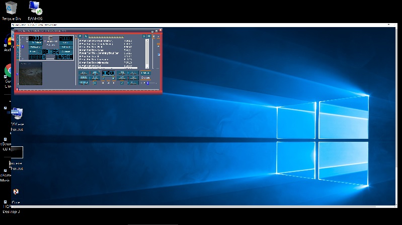

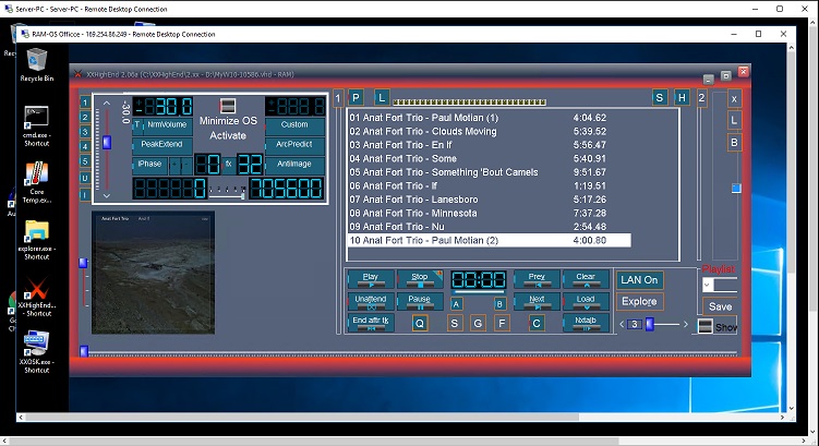

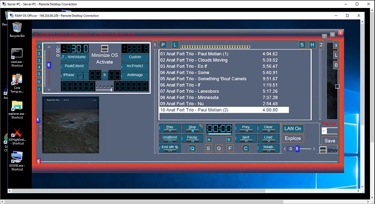

I just updated my RAM-OS disk per Peter's instructions. (As an aside, I also had an issue with the Windows 7 DVD DownloadTool. Tried on a W7 and W10 machine, but got the same error message as Juan. 'isotousb.com' worked perfectly - thanks Robert.)
I then loaded XX2.06a onto W10586 base on the RAM-OS disk. Now, I use the same RAM-OS disk on two totally separate audio PCs - one in my office and the other in my main room.
The office audio PC works perfectly. But I've got an annoying issue with the main audio PC. I'm having what looks like a scaling problem when coming out of Unattended. The only solution is to then close XX and open it again - the scaling problem is then totally resolved.
I'm using exactly the same hardware and RDC connection as before - coming out of Unattended has worked perfectly with XX2.05 since I received the RAM-OS disk at the beginning of the year. I'm made no changes to the RDC whatsoever.
I haven't seen anything in the scaling and skinning tutorials (http://www.phasure.com/index.php?board=12.0) that seems to address this issue.
Any ideas?

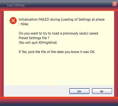

« Reply #1 on: July 24, 2016, 11:21:53 pm »
Not sure if it's related, but I've had the 'initialization failed' error message on both audio PCs.
Also, before applying a presetloader.XXSI, I was not getting the full path in the XX title bar. (I've used Peter's screenshots here, but mine were/are identical with the 2.06 replaced by 2.06a).

« Reply #2 on: July 25, 2016, 08:56:25 am »
Remember, the TRIAL OS is totally unrelated to this all.
Strangely enough I have been working on exactly what you have there, and it was solved in 2.06/2.06a. Nobody ever announced the problem, but now you do *after* installing this version.
This has to be related to some sound device different setting (for the both PC's you use). But also : keep strictly in mind that you might imply quite strange issues with using, well ... one BASE for two PC's. Understand ?
Anyway that was my first thought when I saw the screen's showing odd, but at second thought the issue starts with that error message and that is internally about sound device stuff.
Can you see whether you have Show Tooltips (bottom of Settings) active and if so, switch if Off and try again ?

« Reply #5 on: July 25, 2016, 12:08:03 pm »
I'm going to go back into Normal OS and switch WASAPI off. Will report back...
Well, this seems to have fixed the problem. Everything is working fine when I use RDC with a 1920x1080 screen.
But when I use my laptop with a 3200x1800 screen, the XX window is 3-4 times smaller and pushed up into the top left-hand corner when coming out of Unattended. As before, closing XX and restarting brings the XX window back to how it was originally (before going into Unattended and then Alt-Xing out).
Nothing else to say, I don't think...
« Reply #6 on: September 19, 2016, 12:55:08 pm »
I'd like to revisit this thread...
I'm having to close and re-start XX whenever I come out of Unattended, because the XX window comes back totally messed up, just as I showed at the beginning of this thread. It's getting quite tiresome now. I've also now ascertained that this re-scaling issue is unrelated to WASPI being on or off in the audio PC (contrary to my earlier earlier findings).
I can also now say that this issue is totally independent of audio PC hardware, as when my new Mach II is connected to my main system (stellar sound BTW... more on this at a later point), it exhibits the exact same behaviour as my previous audio PC ('Le Monster').
But for me, the really crazy thing is that this re-scaling only seems to happen in one of my systems. The issue exists in the following chain:
controlling PC (desktop/laptop) -> RDC -> music server -> RDC -> main audio PC
BUT... it doesn't exist in this chain:
controlling PC (desktop/laptop) -> RDC -> music server -> RDC -> office audio PC
In other words, when the Mach II was in my office, there was no re-scaling issue. Only when I took it into the basement did it start showing the same re-scaling issue as my previous audio PC there. Oh, and the two (Mach II and Le Monster) have the RAM-OS loaded from two totally separate hard drives.
Anyone else having this re-scaling issue whenever coming out of Unattended??? Any ideas how to solve?
« Reply #7 on: September 19, 2016, 01:32:14 pm »
Mani,
Can it be that you work in full screen ? If so, this implies additional complexity. In that case drag the screen smaller (do that at the right side is advised).
If it is not that, maybe you've set the resolution to something which is not legal. Hard to explain, but say that already with the video card in and not over RDC the resolution is already wrong for aspect ratio (egg-shaped wheels and such).
Or, you've set the Monitor's "DPI" percentage to other than 100% (125%, 150%, custom value).
I am not saying that the latter two are not allowed, but it may explain why you run into such a rare thing.
Also think about the (different) relation between the remote control screen for the office and the main system. Read : what would happen if you try to use the office remote on the main system.
All of the above is just hints. The only thing I know which may work out oddly (and then even some times) is when using full screen. Which btw is "where" exactly when using a remote ??
« Reply #8 on: September 19, 2016, 02:35:23 pm »
It doesn't seem to be related to running RDC and/or XX in full screen (see attached). These were taken from the desktop PC in my office, which is what I normally use to RDC to the music server when listening to the audio PC in my office. I have never had an issue with scaling here. How can there be a problem now? I mean, the configuration is exactly the same, except the Mach II now connects to the NOS1a in my basement, not the one in my office. (Hey Peter, remember when I told you that HQPlayer seems to like one NOS1a and not the other, could this be related at all???)
I don't have an audio PC in my office right now but will try the Mach II back in the office at some point.

« Reply #9 on: September 19, 2016, 02:57:05 pm »
(I later injected this sentence : it can well be that XXHighEnd does not expect sizes to be larger than 2500)
The key must be in this, while this is not "normal" so to speak. I think that -when digging deeper - more things will appear to operate strange. So notice :
Normally any remote is smaller for physical size and resolution than the device it controls. The effect ? (when all has been set as should) : you will see the virtual control (size) on the original screen, smaller. No problem.
But now your bigger ...
I don't think this can work (read : in general, and this is not XXHighEnd related).
What can be done though is that this remote is first set to a resolution which is as large (small) as the controlled PC, like 1920x1080 and then the RDC data is set.
This is far from easy to explain, with to be sure my reference to opening the RDC settings in Notepad and change all from there. See attachment for an example and do notice that depending on what one wants it can be crazily difficult to get all where you want to have it (don't copy anything of that example as it is not XXHighEnd related; it is just  a very "difficult" example). Anyway that not assumed, this is your target :
Get the remote at a size which is normal and which especially is the LOWER resolution. Why ? because else the scaling will be insufficient to get all shown as large as you want. Example :
If a button is originally 40x15 pixels and this was made with 800x600 in mind, then your 3200 resolution at a physical same size screen (or even smaller) will make that button 4 times smaller. Thus, it is still 40x15 pixels, but 4 times more (in e.g. width) fit on the same screen size. This means that you want to scale 4x at least, while only 2.7 max is available.
This is one.
Two is that most probably you have not set that resolution on the hist (the Audio PC) so all is mapped in "illegal" fashion but very much dependent on how you have set things in such a settings file. Generally : If you are able in the first place to create something in "a" remote with a 100% correct aspect ratio, then you apparently know how to do this. Btw, this is already too difficult for 95% of people (who just don't see it is wrong in the first place). This IOW : only when you know how to do this correctly, you also know what to achieve, plus you understand what I try to bring across, which is super difficult to begin with.
a. Set Audio PC to 1920x1080
b. Set Remote to 1920x1080 *if* it can exactly take that. If not, set the Audio PC to a smaller screen size - one which the remote can take.
c. Add the Smart Scaling line with i:1 (different from the example below).
d. Take into account that maybe it is not possible to achieve what you want.
Ad d.
It really us difficult to put myself in the situation of that remote having a higher resolution than the host.
Ad a.
Don't forget my remark about the 4x smaller buttons and what you will have "mangled" to overcome this. Contrary, you should avoid this mangling. Understand ?

« Reply #10 on: September 19, 2016, 03:21:27 pm »

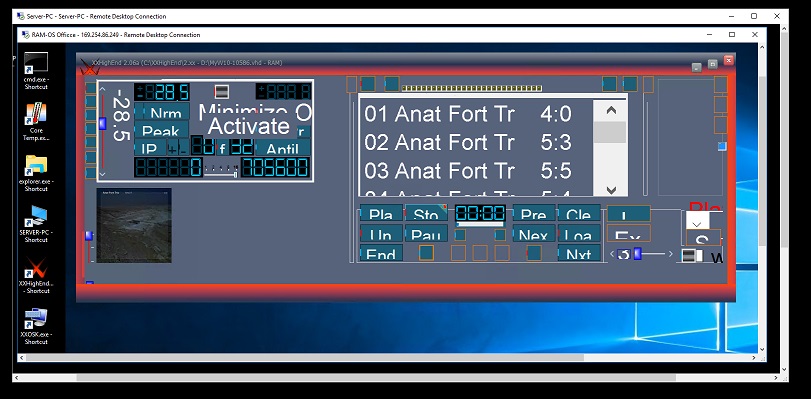

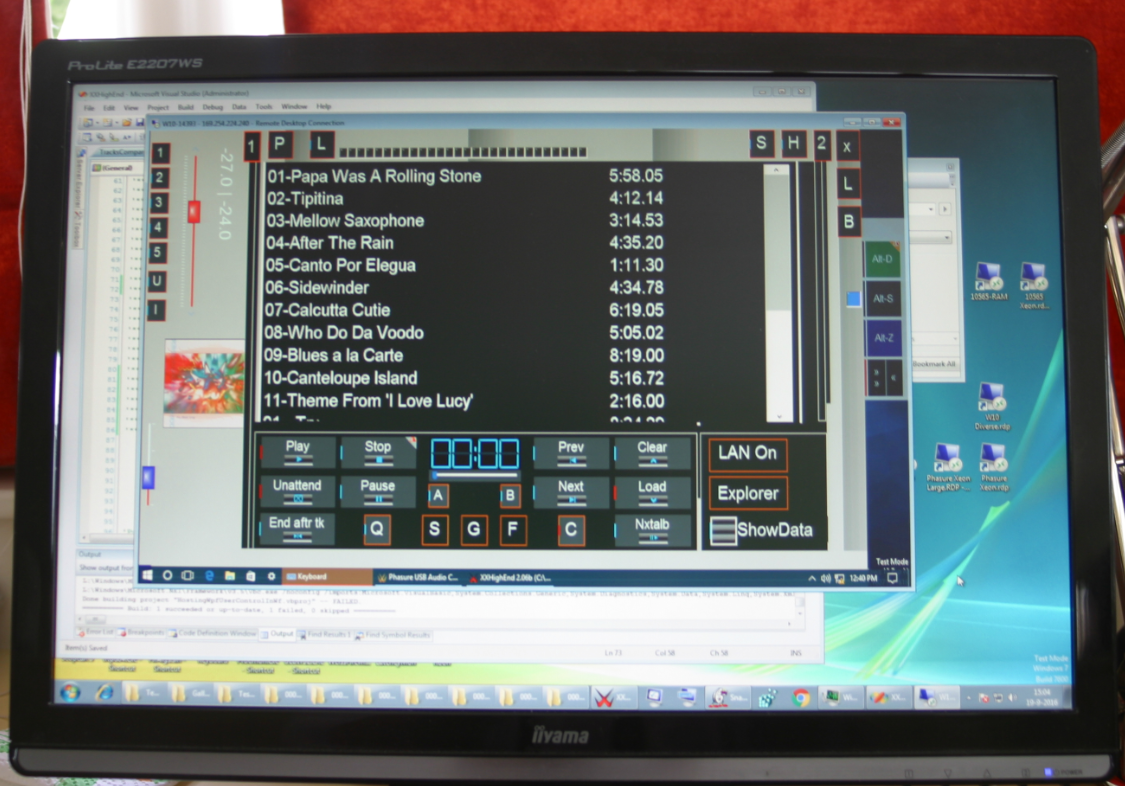

Mani, this confuses me; You talk like "see, they are fine !" but they are not.
Apart from that this is obvious, let me tell you the most explicitly that already the first screenshot is very "wrong". If I see correctly, I see a desktop, inside of that some screen with scrollbars and inside that again a screen with scrollbars. This, while nothing but the original Audio PC's screen should be visible (this will be your inside screen - the one with the blue Windows 10 background).
See below ...
The first picture is of my Music Server Screen (screen is 1680 x 1050). The inside window is the one which is to appear on my tablet. It already there is the exact same resolution (which is measures !) of the tablet. Thus, in the RDC settings file there's 1366 x 768 or whatever exactly (just look at the tablet and make it the same in the file, which is impossible in your situation unless the Music Server Screen is also 3200 x etc.).
Second picture is the tablet after taking over. See ? no other screens visible anywhere. No scrollbars either. Only the taskbar of 14393.0 which does not want to disappear. Happy
On a side note, the aspect ratio is 100% OK because I never changed it. Thus, the original (which virtually is the tablet) is made equal to that on the Music Server PC and the space XXHighEnd occupies is just by dragging the borders (this does not change the aspect ratio).
The "size" of the Audio PC is not even important (I now think / see). Remember, the Audio PC does not even have a video card inside BUT in my case it has been set to 1280 x 1024 (its monitor when attached is that).
Notice that when you allow those scrollbars, you will never ever force yourself to do it right.
... But keep in mind that maybe the larger 3200 on the remote may make things impossible to set right. Otoh, setting that remote to the lower resilution, and all may be fine. May be.

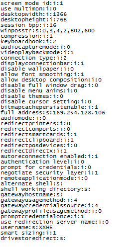

Attached you see the Notepad file of the RDC setting on the Music Server PC (towards the Audio PC). Notice the 1366x768 in there, which is from the tablet and which is the one controlling the Music Server PC.
All not so obvious eh ?

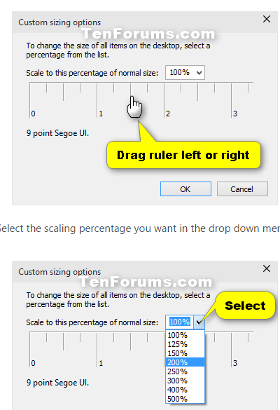

« Reply #13 on: September 20, 2016, 09:04:47 am »
Mani,

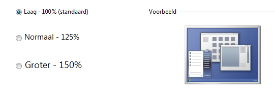

What is the Scaling Factor in XXHighEnd ?
Also, what is the display DPI setting on the laptop ? (see below, 1st is from Windows 7, 2nd is from from Windows 10)
« Reply #14 on: September 20, 2016, 09:23:23 am »
Hey Peter, here are my current settings:
- XX scale factor = 1.7
- controlling desktop:
   - resolution = 1920x1080
   - W10 scaling level = 100%
- controlling laptop:
   - resolution = 3200x1800
   - W10 scaling level = 250%
To be absolutely clear, when I'm using the laptop and come out of Unattended, XX looks as above (2.5x smaller than before Unattended - but with the text scaled correctly). But closing and then re-starting XX brings it back to the 'correct' size. So, whatever re-scaling mechanism is working on the restart doesn't seem to be working when coming back from Unattended. Does this make sense?
