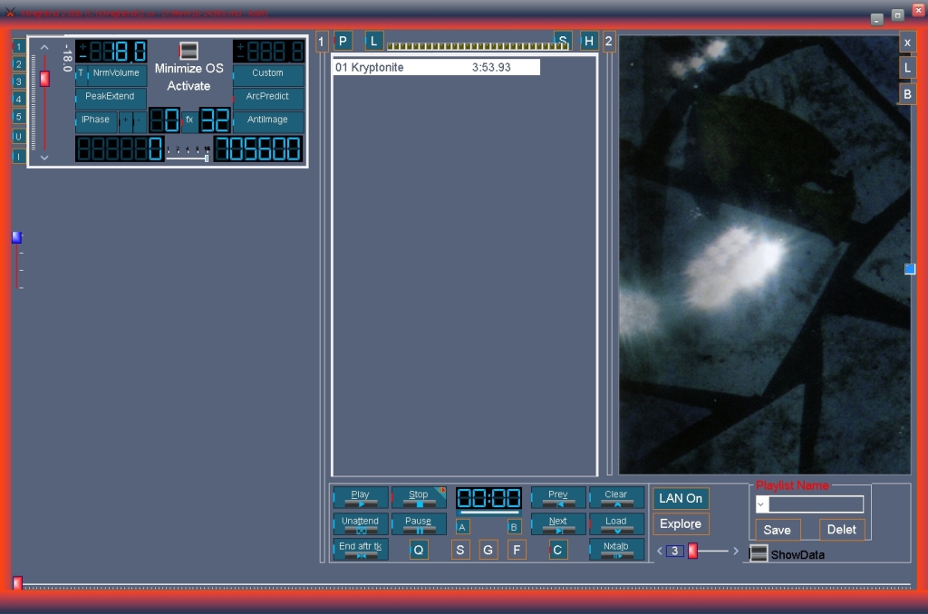

Sorry for the delay...
« Reply #16 on: August 14, 2016, 04:35:36 pm »
I know how to remove it, at least I think. For the moment I am in RAM mode so I am not sure if it will not be there even if I save the changes on drive, but it is just a leftover...
« Reply #17 on: August 14, 2016, 05:00:51 pm »
Ah, that ...
No, that is on purpose.
Anyway (for those who don't know) : Skin settings ([ S ] button with the Playlist Area active) - CoverArt Background Image. Empty that field and all should be "clear".
Thank you Alain.
