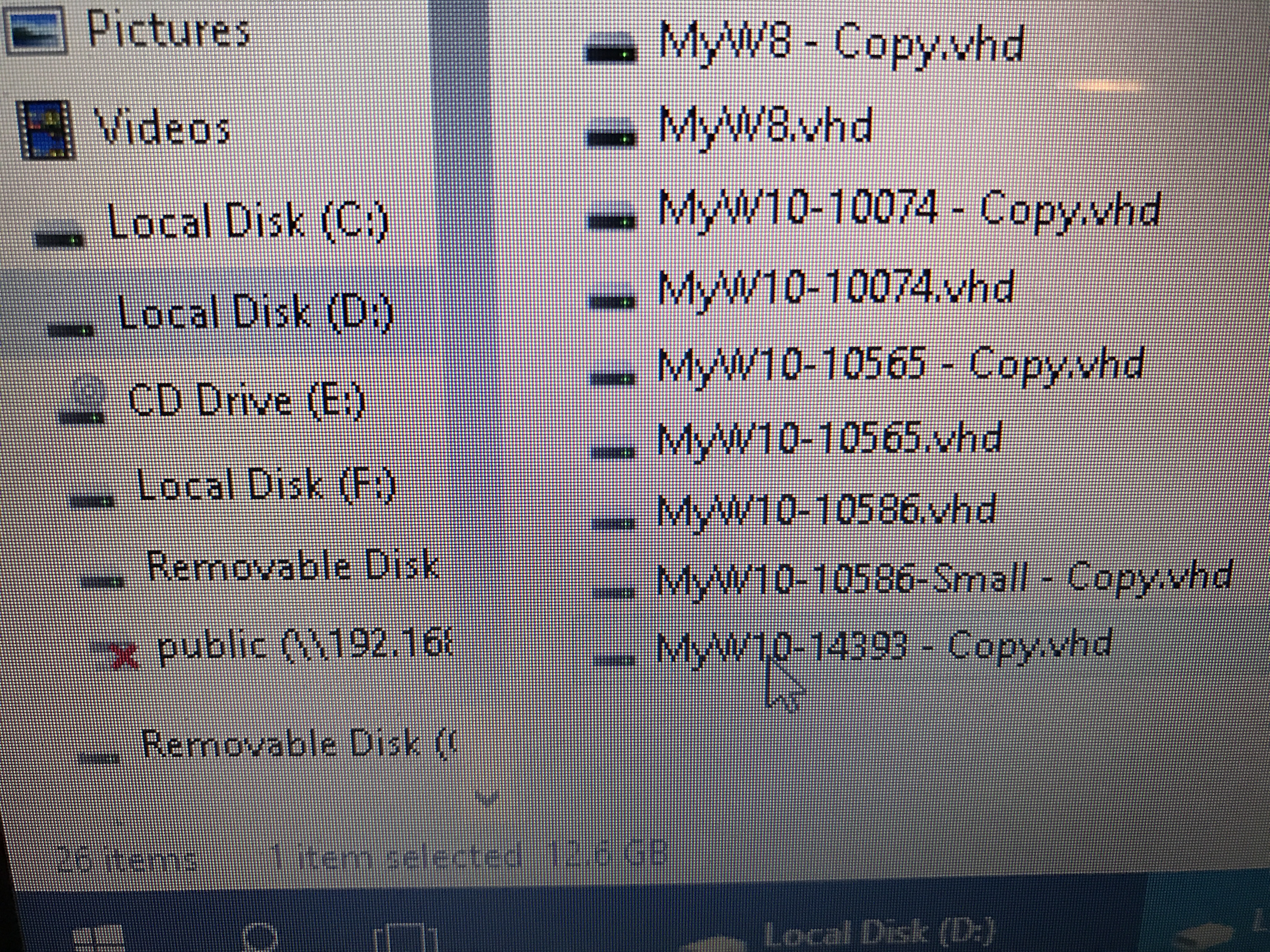

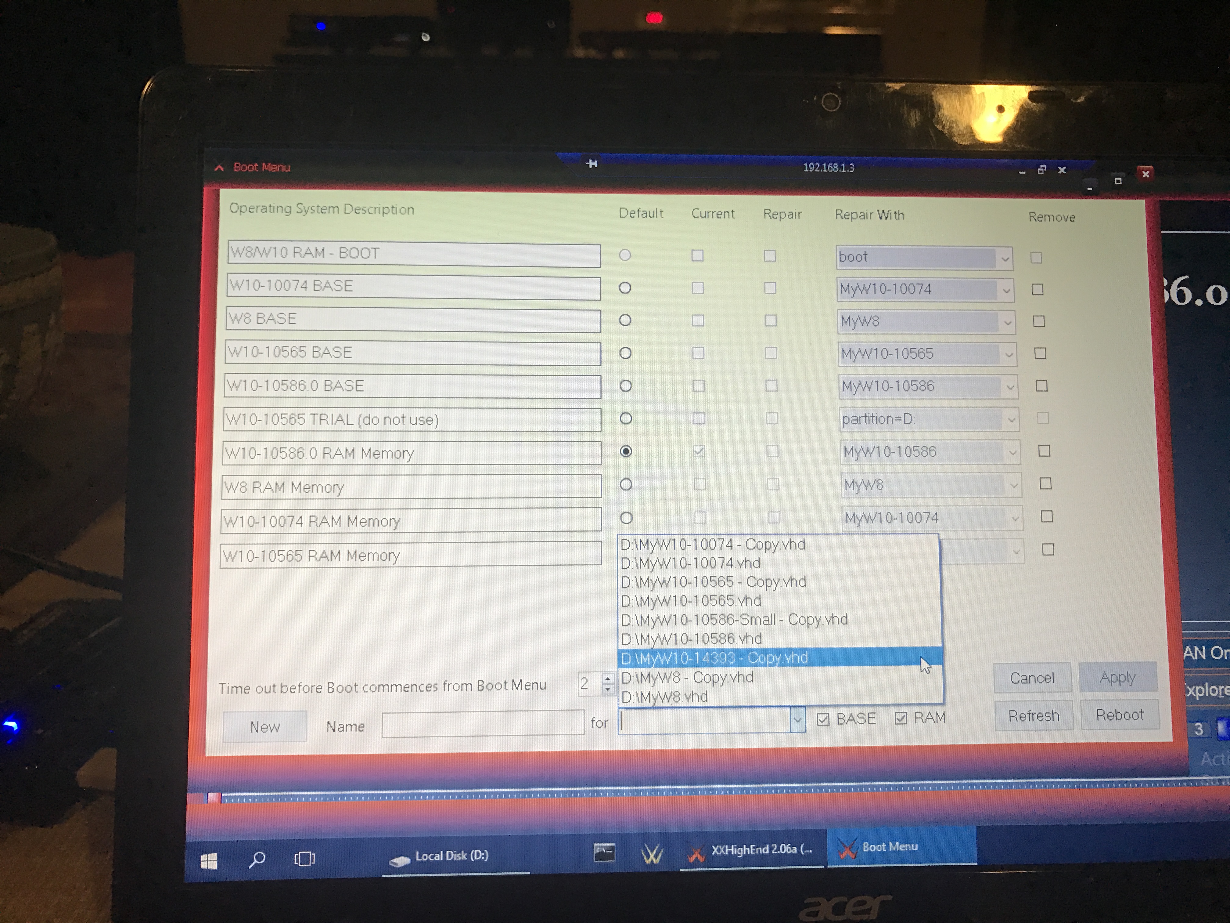

I am attempting to add 14393.0 to the RAM OS disk using method 2. The file has been unzipped to drive D. But I am only finding the Copy version in the drop down menu.
I have attached an image of the Boot into.
I think I should have the OS other than the Copy version.
Am I doing something wrong?

« Reply #73 on: October 13, 2016, 05:36:07 pm »
Hi Arvind,
That name with the "Copy" in it, concerns the upload by me with the wrong name; it should be renamed to
MyW10-14393.vhd
I think the message to do this came along with the email containing the link, but anyway it is my bad.
If you still have problems with it, don't hesitate ...
PS: You can keep the "Copy" version somewhere else as a backup, hence you don't need to keep that on the SSD (taking space). And of course you can download it again when needed.

But there is only one OS version after unzipping; Copy.vhd. Unlike other OS have .vhd version & Copy.vhd version.
Image attached.
Sorry for the large image size but no way to make the size smaller on the iPhone.
