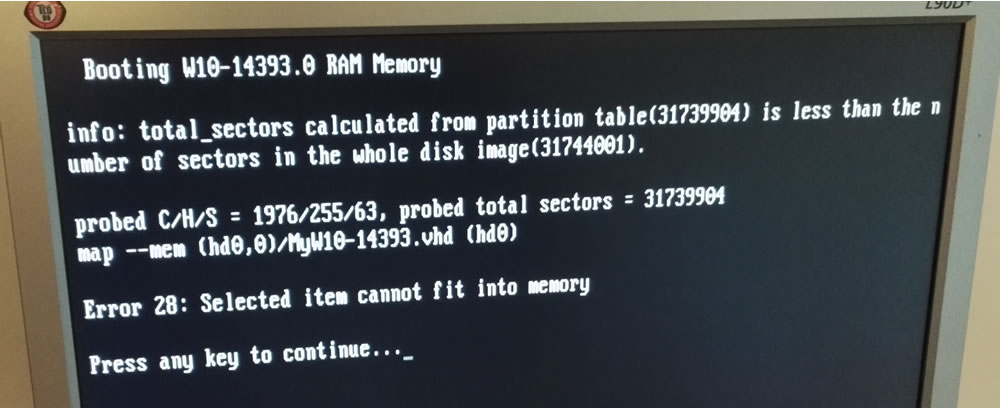

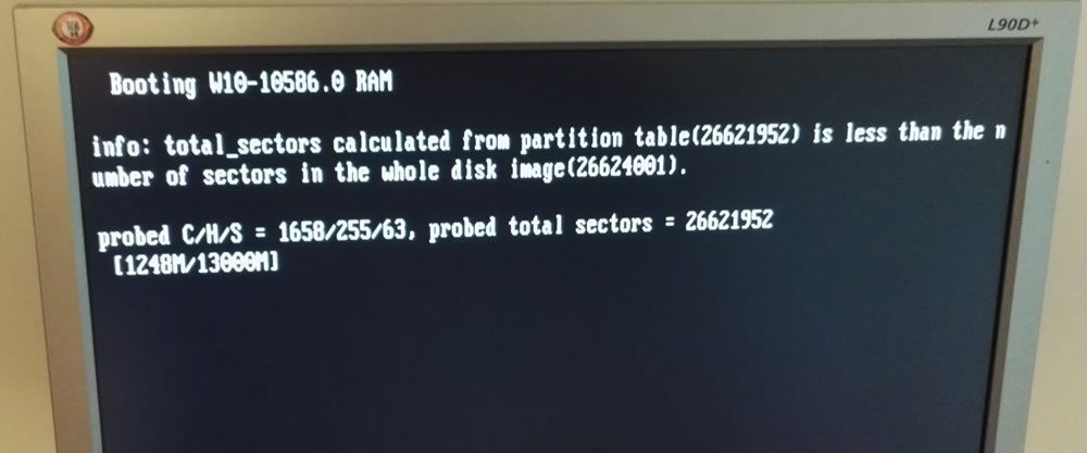

anyone facing the same problem with loading W10-14393.0 into RAM on a PC with 16GB RAM?
See pics - W10-10586 is loading fine.

No, but I now have 32GB. Even with expanding XX Ram space to 18GB, running an album of say 7 or 8 tracks at 24/192 only leaves 145MB of space in C drive with 14393. All runs perfectly so far.
Recommend you add more Ram if possible, Windows is only going to get bigger over time.

Maybe I made a thinking error, but it is caused by something strange in the first place - that size the OS consumes. So, what I saw was almost all consumed (900MB free) for the normal 13GB I created, while that should leave over 3GB of normal space. It left me one thing : make the OS (file) 2.5GB larger ...
Nice ... but 13GB becomes 15.5GB because of that and with 16GB of memory, the OS itself has 500MB left. I don't think that will fit.
(I hope people can follow, and otherwise never mind too much)
BUT
The 13GB is not really 13GB (but 12.x, because that is how it calculates) so theoretically there should be "hope". Also, personally I don't see how the system can know that 15.5GB of "stupid file" is not going to fit in 16GB of memory, if it were about after the loading of the file, the OS itself must be somewhere too. Thus, what I'm saying is that this loader does not know about any OS being loaded later; it only copies the file to memory and *that* does not fit.
My hunch :
This is again about video memory mapping and assumed that your video card has 1GB of memory, this will be subtracted from the available 16GB. This is how it (stupidly) works. So I think that *that* is the problem now. And video cards will not come with less memory these days ...
Btw, I have no idea what will happen when the video card is out; so if you first set up the RDC stuff, then you could try, but ... (but it would be quite awkward).
In the very end the problem is caused by that strange memory (no, disk !!! <- but which is memory) occupation of the OS itself. I just don't believe that and it must be something temporary (read : harmless).
All what remains is what I mentioned elsewhere : shrink the OS again, and try what happens for real with it. But, with the notice that I can maybe shrink it with 1GB (and not with the 2.5 I additionally added). Then put that up for download and retry ...

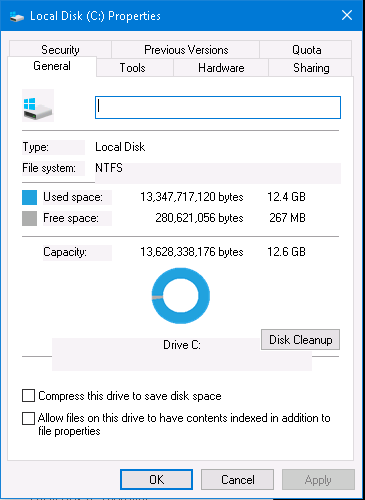

Booted from RAM and look below. 267MB free.
So, same story and I haven't dreamt it.
Something just is not right or for real or whatever it is ...

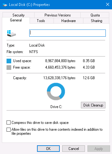

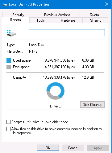

First pic below is from the BASE disk.
Second pic is when booted from RAM and which requires shutting off Hibernation ... AGAIN.
So what goes wrong is that this does not stick now.
3.5 hours and a 100+ reboots further, I have found the solution. Last pic is from that (booted from RAM).
That is a total of 6.5 hours for something which normally worked in the previous W10 version.
A new and normally small file (13GB) will be available soon.
