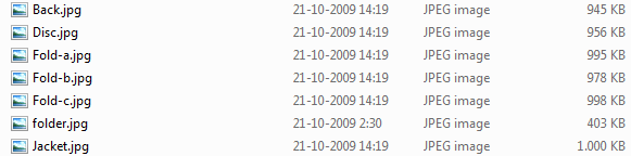

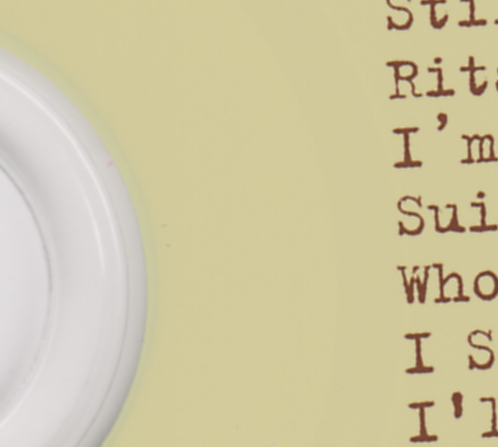

« Reply #9 on: September 04, 2016, 01:39:21 pm »
Trust me that I have the same album from the exact same source (not that I recall the source, but I just can see it). But look below to see the file sizes; that has been done by XXHighEnd. I also changed the names.
The quality and size (for zooming the small print) really can not be distinguished from yours.
