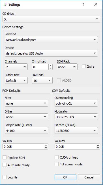

I also come to this "conclusion" because looking at it in the way I want(ed all the time today) I am reminded by the dithering XP always did and it just looks like that. So ... maybe you forgot to switch off Dithering in HQP ?? (I suppose it can do that at 16/44.1 just the same)
XXHighEnd does not dither.

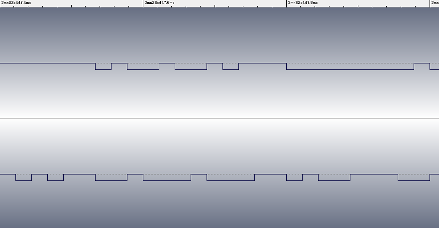

Below you see the difference file of it. This is always 1 decimal of difference. And yes, earlier on I said "1 or 2" but I think I misread the hexa-decimal data somewhere.

So ... maybe you forgot to switch off Dithering in HQP ?? (I suppose it can do that at 16/44.1 just the same).
No definitely no dithering in HQPlayer.

Thinking further ... it is hard to dictate this all to rounding errors, with also the knowldege that expaning to 32 bits without upsampling, should just add (padd with) zeroes. Also I am not even sure any more how XXHighEnd deals with this these days (or better : 5 years ago, because it must have been that long that I looked into that for the last time).
I set DAC to 16 bits in XX. This is the only setting that would work with my 16/44.1-only capable Legato USB-to-spdif converter. The 'DAC is 24 bits' and 'DAC is 32 bits' buttons became grayed out once I selected 'DAC is 16 bits'. I therefore assume there was no padding going on.
