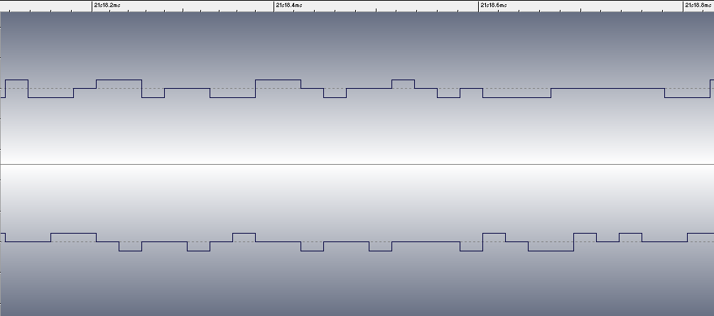

« Reply #102 on: November 07, 2016, 04:20:01 pm »
The difference between the original mR recording and the v3 version ...
Plus and Minus deviation.
No, I don't get it. scare
