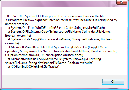

Well, I just installed v 09u-1. I tried to do the dac test. As soon as i hit play i get an error that the file is already in use or something like this (i'm trying to replicate, because i didnt save it in photoshop before the BSOD).
Hitting ok, error again, and it loops.
I shut down xxhe and this time without doing anything i hit play, and it started playing without errors. I hit stop and poof, BSOD irql_not_less_than_equal

« Reply #21 on: February 23, 2008, 05:30:31 pm »
OK, (after rebooting) the error appeared again, so its replicable.
Here u go.

« Reply #23 on: February 23, 2008, 05:34:04 pm »
Here u go.
Ah, okay. But this is solveable. Try a normal WAV file. This is most probably a FLAC or MP3. yes

« Reply #25 on: February 23, 2008, 05:37:37 pm »
OK, will try.
Unfortunately also the BSOD when stopping playback is duplicable unhappy
