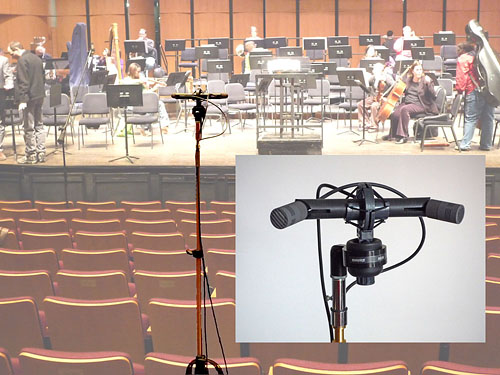

Stereo over two loudspeakers works by creating a phantom acoustic scene between the loudspeakers. In its simplest form a single monaural signal is fed to both left and right loudspeakers. If the two loudspeaker levels are identical and there is no phase difference between them, then a listener on the center line between the loudspeakers will hear the monaural sound as coming from the center though there is no sound coming from that direction. This is basically a very unnatural event and so a slight movement to the left or right will shift the phantom source to the nearer loudspeaker.
Courtesy of Linkwitz
Combine the last text with this picture (please notice that in the original text this picture is not related to the above text; this is my own "creation"). Now :
What I referred to in my first post is the in my view fact that such a microphone is not able to capture any stereo image in the deadened room. Mind you, while such a microphone setup is used at the distance, the more normal in-studio setup will be a single microphone, were it about a solo singer (as part of a band, but with the explicit notice that studio recordings usually or at least most often are not taken with the whole band playing together). Thus, a mono signal, or otherwise a stereo signal from the two-mike setup but too close to each other to form a real stereo image of proper size (and if at all the size would be of the distance of the mikes, but superimposed by reflections, if there to begin with).
Anyway, it is not allowed to think that a studio utilizes such a mike setup and create the stereo image at the same time. The studio is NOT a concert hall with explicit proper acoustics. A studio usually is as dead as can be. It will create a dead sound as mono is. Of course unless explicit mike setups are being tweaked in (like a couple more at a few meters distance from e.g. the singer, but I don't think it happens like that in a studio).
All in other words, there is no stereo image recorded in the studio, and chances are very fair that such a voice recording ends up on one channel to begin with, because just one microphone was used. Right ?
If right, then the stereo is "created" later, by the mixing engineer.
