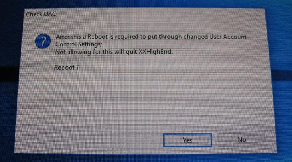

I installed XXhe 2.07 on a fresh Win 10 14393.0 and yesterday I wanted to activate it. So I connected Ethernet cable to get internet, XXhe was set to stop W10 updates before.
But it was impossible, there was a message about http services unavailable.
Back a little. At first XXHighEnd.exe launch I immediately got message you can see at the "UAC" attachment picture. A reboot was required and performed.
At next XXHighEnd.exe file run window "first run" at attachment appeared: but no need to run any program then.

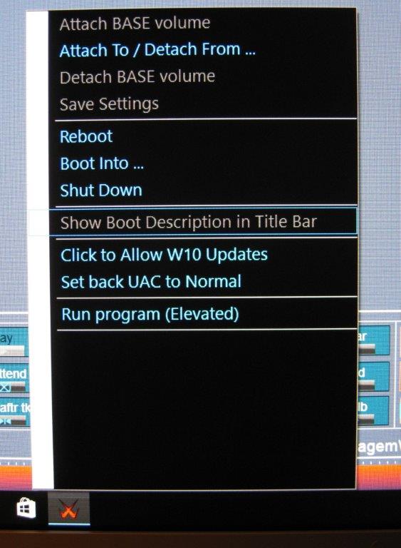

- UAC slider in W10: lowest setting, never notify
- local account, administrator in W10

« Reply #1 on: January 03, 2017, 10:53:31 am »
No, this is most certainly NOT expected; that first message should not appear at all.
I don't get it ...
I assume you are positive that this first screenshot too is from 2.07 ? (the third screenshot definitely shows that you are using 2.07 there).
or
Maybe you already used XXHighEnd 2.06 on this system (which would force the old procedure) and that I don't anticipate that combination ?
Did you try that "Set back UAC to Normal" option ?
Sorry for these troubles !
PS: No need to observe the UAC slider; this tells nothing much (or not all anyway).

Ok, I pressed "Set back UAC to Normal" and was notified that memory would be set to "mixed" then got a window with a error... but was able to reboot.
Now it's possible to connect to the internet. While XXhe plays.
In the "stop" menu I can read "Set UAC to optimized XXhe usage".
What do you suggest to do? To activate without doing anything else?
And what is/was the error ?
You will need that when either
a. you want to use Straight Contiguous Memory;
b. go to MinOS.
And in any event after Activation. Happy

« Reply #14 on: January 03, 2017, 04:04:20 pm »
No ... this was the culprit :
1. In the settings, the Memory is set to Straight Contiguous (abusively, by me).
2. When that is so, the UAC is put down and a reboot is required at startup.
3. Once that happens, Edge won't work (IE still does, but that was not really my idea).
Ad 2.
So that is what happened at your very first startup. Not meant to happen of course, but I never thought of #1 which did not matter previously. Now it does.
