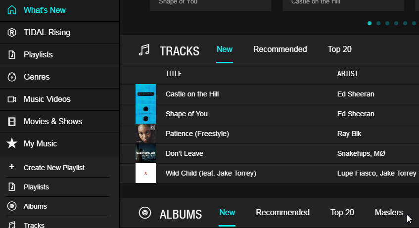

FYI :

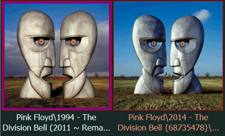

XXHighEnd just plays those MQA albums, which Tidal calls "Masters". But I did not find a way yet to search for them via the program. If you want to try them, look for them first in the Tidal Desktop Application (not the player in Browser version !) under What's New and then in the ALbums section under Masters.
For those who can't easily install the Desktop Application, here's one you can search through XXHighEnd and find the right one unambiguously when you type this in Album Name :
The Division Bell*
The one you see below is the one you need and notice that this comes forward as a 16/44.1 because it requires an MQA decoder to make it "hi res".

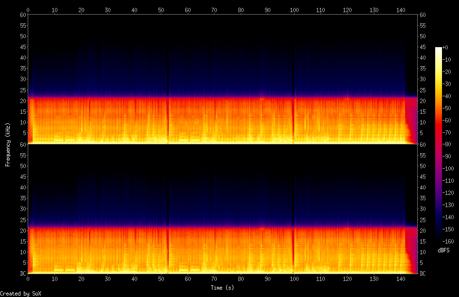

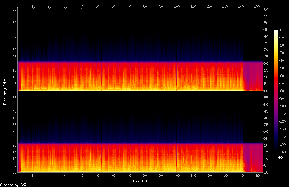

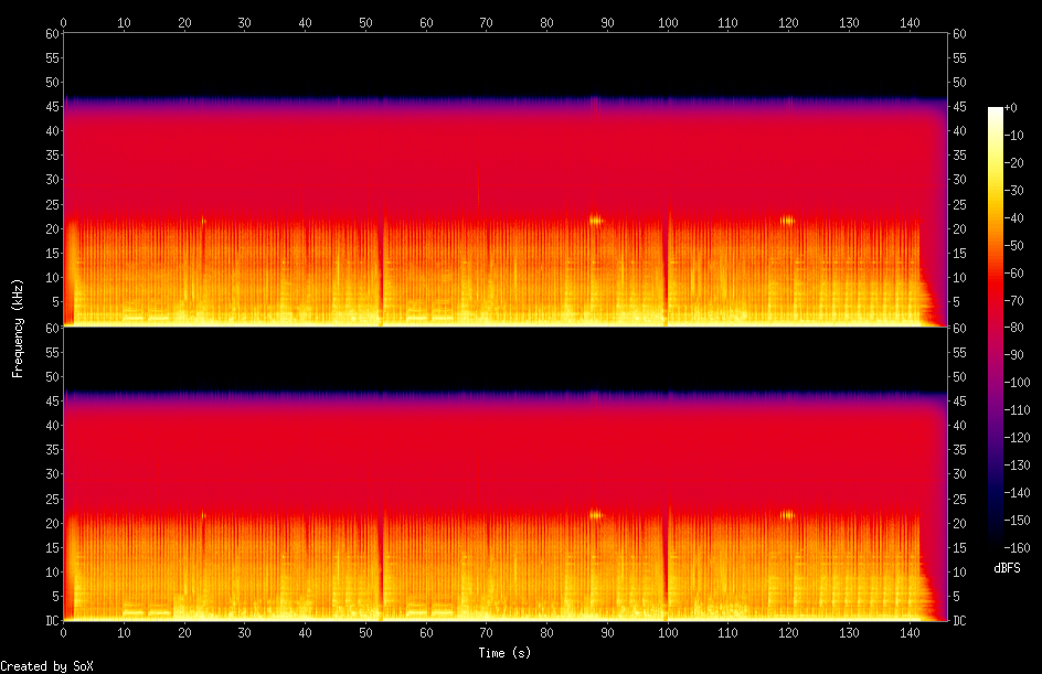

Here's a nice example of what just that tad of extra resolution can do, assumed the (re)master is not flawed.
This is Led Zeppeling III, track 01, "Immigrant Song". If you look at second ~88 and 120 you see that something wants to happen :
While the above is Redbook (16/44.1) with a sharp roll off filter, you can see below what actually wanted to happen (so to speak) :
This is the (software) decoded MQA version in 24/96, with the notice that this probably is a re-recording in 24/96 from analog because of the high noise you see. It can be taken that this noise has been there right from the start in 1970.
OK, wait, here :
So yes. And what we also nicely can see is why we like to avoid Remasters, because it is easy to see how the previous both versions are completely "overblown"; about all ends up at the maximum level of mind you (!) frequency. Thus the Redbook version has more variation in frequency (level per tone). Nice eh ?
