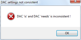

I did this too.... It play's but before playing this error come's up.... what does it mean?
Grtz.... Gerard...... Happy
« Reply #48 on: February 20, 2008, 05:25:30 pm »
That you just changed the setting from more than 16 bits to 16 bits, while the system auto-unticks the either 24 or 32 which was there (the "auto" is not much clear and will change in the next version).
