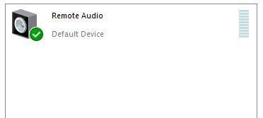

OK, I think I've found the culprit. The mobo in my music server has no integrated audio device. I've been using an old Audioquest USB DAC just for the purposes of launching XX. For some reason, this is now not being recognised correctly by the mobo - it appears in Device Manager but not in Manage Audio Devices. So as far as XX is concerned, there are no audio devices. I have no idea what has suddenly caused this - the Audioquest USB DAC has been working perfectly in the music server for ages, and I've just tried it in another PC and it works fine.
Oh well, I'll probably just stick a sound card in the music server at some point...
