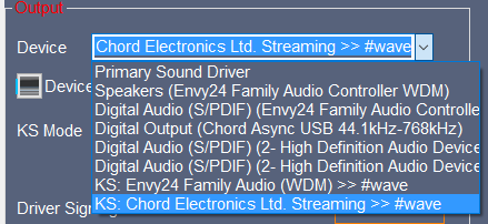

Over the days since my last mail, and a few PC and XX restarts later the list of drivers that I see has changed and is now only showing KS drivers (excluding the primary sound driver), see attached. I don't what happened. Also I added new logfiles based on these new list of drivers. Hope this helps with you investigations

Or otherwise that now WASAPI is shut off again (in XXHighEnd Settings) which previously resulted in nothing in the list (IIRC) ? Or that you changed active devices (you can disable them) ? Anyway, no need to answer if you feel the current state of matters is no problem (outside the upsample rate of course).

yes, that must be the case. Returned to Normal mode a few times as requested by you to get the logfiles needed, but moved back to minimised mode with Wasapi off, now showing only the non-wasapi drivers.
I'm quite Ok actually with the current KS mode drivers and it is easy to switch between the two. So, for me what is left now is the question why I can't go to a higher upsampling rate.

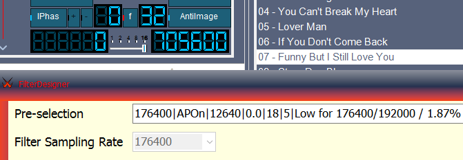

So, that is solved, but what I noted was that the filter setting was still on 176400 instead of 705600 and it worked, see screendump. So, does XX not check on this Filter setting? Well, yes, it seems it does because if I set it to 705600 and then go back to original driver settings (176400) I get an Q5 sample rate mismatch and this makes sense. So what happens if I select this new Chord driver with 32/768 setting and 16* upsample rate but leave the filter on 176? I don't get this Q5 message.

The setting of a "too low" filter is allowed, but a kind of a waste because you won't be utikizing the upsampled headroom for the Custom Filter. So, not advised but allowed (the other way around is not allowed because we can't filter beyond the Nyquist freqency (in this case after upsampling)).
