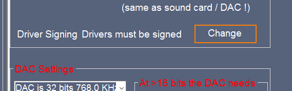

Settings when starting XX from the bootdrive (to my idea also the basic configuration for booting into RAM).
From boot drive all is OK, checking the same settings started from RAM not at all...
Is this normal?
The images are from a RAM drive configuration. XX from HDD it shows Stable, Optimal and no need to Sign the drivers...

Also notice that this is about OS settings and not XXHighEnd settings or dynamically by XXHighEnd changed settings. You must really press those buttons ("Change") before something is applied to the OS and which comes through after a reboot.

Changed to BASE and changed the settings still being in Minimized Mode:
- Stable to Not Stable and vice versa (2x reboot)
- Optimal to Not Optimal and vice versa (2x Reboot)
- Changed to Normal Mode (needed to activate new settings where certain services are needed) and back to Minimized (2x reboot)
From there back to booting in RAM and now all looks the same except for Driver Signing as this is not (?) related...
