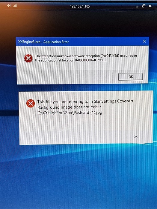

Peter, lately 2.09 stops suddenly sometimes before playing anything, sometimes after playing the first track. It looks also that the memory is out of storage, could be because now I'm using SFS: 10?
These are the messages:
« Reply #1 on: December 04, 2017, 04:50:18 pm »
Hi Juan,
Looks more like a virus, or a virus scanner to me (I know, both are a bit opposite). But that NOT assumed :
Did you check your Max SFS setting ? I found mine on 2850 yesterday and this does not really look right. It may consume all the memory and this is what you are thinking of to begin with (I don't know how, but ... Happy).
Postcard(1).jpg does not exist from over here. Only if you put it in there yourself. So maybe check whether it really exists.
The first message you showed I have never seen but very theoretically could spring from DEP (Data Execution Protection) - notice that Google shows me no proof of that.
It can be hardware too, I think.
« Reply #2 on: December 04, 2017, 07:28:15 pm »
Thanks Peter, I deleted the Postcard.jpg file and so far it works fine. No idea how it was there.

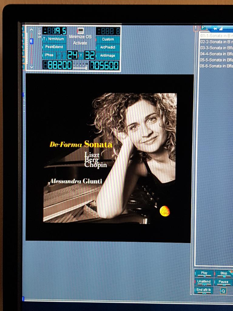

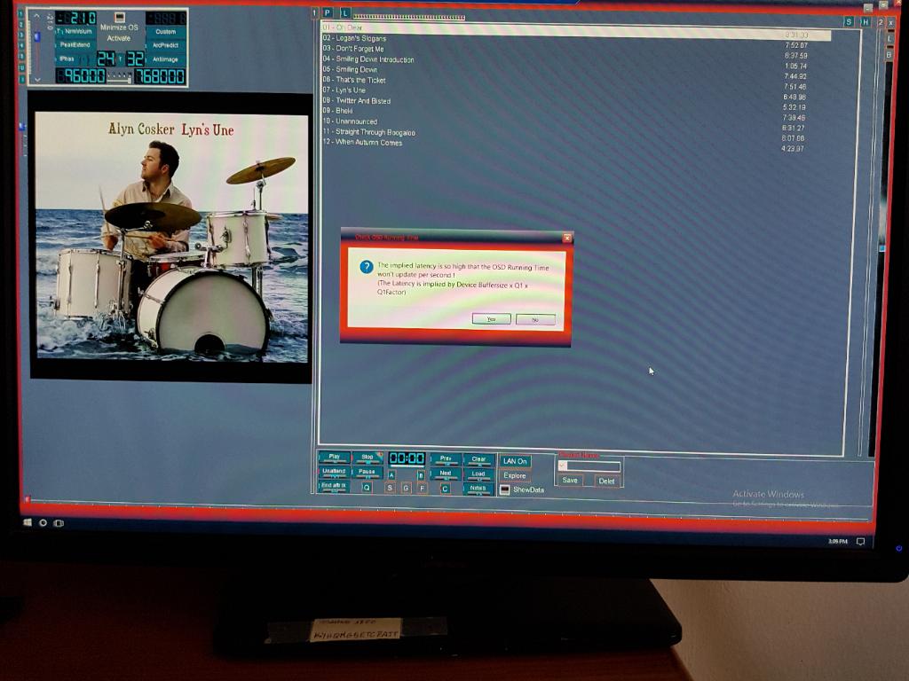

Hi Peter, testing some high resolution music I have had the same problem with this one
« Reply #11 on: December 14, 2017, 11:35:01 am »
Total running time ?
« Reply #12 on: December 14, 2017, 11:46:01 am »
Not playing at all, 0 seconds.The running time was inactive. Also happened with this one and after activating the running time I got that message.
There is no sound either.
Now my settings are :
SFS :8.98
Q1:30, xQ:40, Q3,4,5::1,1,1
ClockRes :15ms
Driver:16ms
So, similar your settings
« Reply #13 on: December 14, 2017, 12:43:04 pm »
Hi Juan,
I was referring to the total time of that Hires album (like 60 minutes).
« Reply #14 on: December 14, 2017, 03:15:49 pm »
Hi Juan,
Peter, the running time are:
De-Forma Sonata: 75'74''
Alyn Cosker: 76'06''
