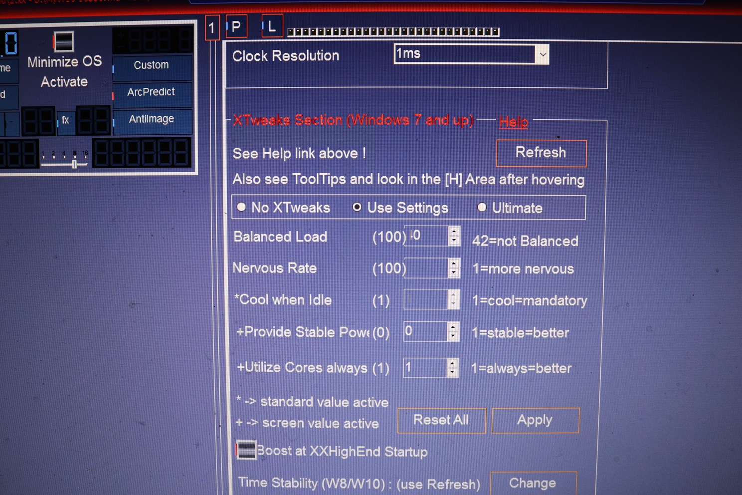

Morning Peter. This quote is from the 2.06 release notes. The part in bold made me think that the Nervous Rate setting of 100 is automatically set to that value when one engages the "Mach II" button, because that is what happens here. As soon as I untick the Mach II button, I am able to reset the nervous rate to 1 and it persists.
HOWEVER: I noticed and heard this morning that upon boot up (I turn the audio PC off at night) the nervous rate value returns to 100 and I must manually reset it whenever I boot the system, even though the Mach II button is not activated. See photo below, which is taken imediately after boot. The left hand parenthesis is covering the 1 setting for the nervous rate. It stays at 100 until I engage the apply button. Again this is only after a reboot. This behavior also occurrs in 2.07.
Is this just my system or do all those with the MACH II button engaged have a nervous rate value of 100?

Hi Brian,
I can confirm this is a bug; happens to everyone. So regardless of the setting of the "Is Stealth" button, at startup it is regarded as "Yes" always. So it is not related to a reboot. And, how it can be that you don't see it go wrong at a restart of XXHighEnd, I don't know. So over here it *always* resets to 100 (and the Cool when Idle will be set to 1 as well, although I did not test this).
Don't forget to click Apply when you change it for the session.
It is solved for 2.10.
