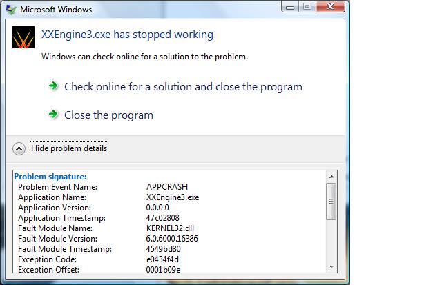

Also tried Linns free test files (24/48), among them some WMAs. Converted these to standard WAV by NCH Switch program and the finished WAV plays fine in MP11. Playing them in XX gives only a loud hiss. When XX comes to the end of the files it crashes in Vista giving out a standard Vista Application crash message, listing versions of .dlls etc.

Error message:
