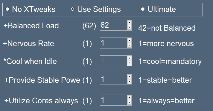

Hi Robert,
Not necessary to be alarmed because it will keep it under control. Btw notice that the means you use to observe the temperatures will let rise the temperatures just the same.
Point is : with the extra fan power (2nd switch) the sound may deteriorate a little. Will that be noticeable - maybe not. I have it down as well.
If you "mangled" with the other settings (set to 1 and set to 0) and you recognize it is since then, then I would restore those to how it was (they have fairly high impact).
See my settings below which are good to go.
The main culprit could be the Balanced Load set too high (see mine at 62), but notice that when you bring up XXHighEnd after playback, the normally cooling feature - never mind playing - will not be active. Thus, you may test all with XXHighEnd crossed away again (then cooling is again active) and leave it like that when not playing.
This way you can't see temperatures, but you might see the light not coming on now.
I have that light always in sight and I think it is a good habit.

Hi Peter I'm running your photo of settings didn't make any difference in temp. Anyway here's what I have observed:
