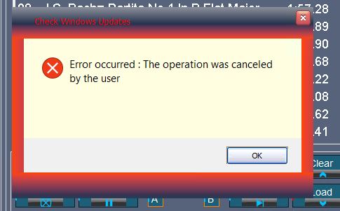

- when I right-click on 'stop' to reboot (or whatever), I get a strange message (after clicking OK, I can click reboot (or whatever) and it works fine)

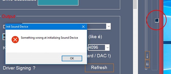

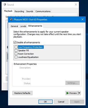

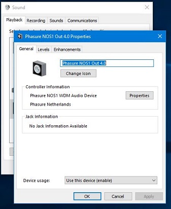

Edit: right-clicking on sound device shows the NOS1, but not the 'advanced tab'

« Reply #3 on: April 06, 2018, 12:27:29 pm »
This is the same issue (??) as dealt with in the HQPlayer topic ...

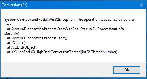

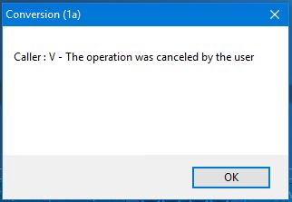

« Reply #8 on: April 06, 2018, 07:01:51 pm »

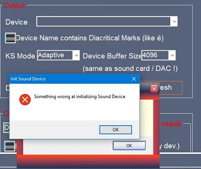

A couple of 'conversion' errors in MinOS may give some clues. Here, I've simply pressed Play, with Unattended selected. Clicking 'OK' to these errors, Unattended play starts... but the desktop remains throughout (doesn't go blank).

The only outstanding issue is that when I attempt to play XX in Unattended, I still get the two 'conversion 1a and 2a' errors before playback starts. Clicking 'OK' both times seems to do the job and Unattended play works as normal (with screen going blank).

« Reply #11 on: April 07, 2018, 12:52:03 pm »
Mani, that is a bit vague.
Do you have a screenshot for me ?
« Reply #12 on: April 07, 2018, 01:02:52 pm »
Three posts up Peter...
« Reply #13 on: April 07, 2018, 01:29:34 pm »
Ah, in the Title bar. I didn't look there ...
But I can't do much with that. I recognize it though.
It feels a bit like the under the hood messages "Do you want to run this program Yes/No", and "Show this message the next time ?". So it can be that this failed at the install (because being blocked) and now won't work any more.

« Reply #14 on: April 07, 2018, 02:06:05 pm »
'All Passed'. But the 1a and 2a errors still remain when I go to Unattended play.
