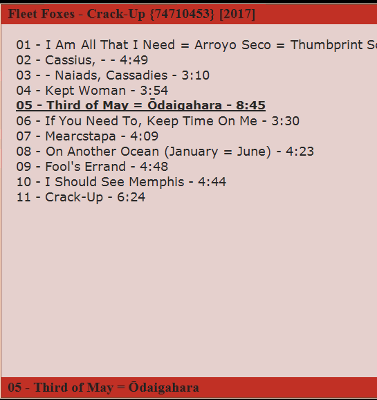

OK Anthony, I wasn't the smartest yesterday; I used your link and next saw one album only - the MQA and thought that was all (swoon). Now working on the other.
... which again plays but now also with Track 05 at the correct speed.
If you go to the folder where all is stored and observe all what's there, you should see the same (odd) characters in everything. So not only the track title (= file name) but also in the .mtt meta data. I suspect it is different somewhere in your system. If so, consider an "odd" disk organization.
Not sure what you can do with it, but know that the "=" in the track name is a replacement of something which can't be stored as/in a file name (could be ":" or "\"). So if that fails somehow, then, well, all fails. I never ran into such a thing but maybe in your system ?
As an extra check you may observe the Wallpaper Coverart - the back of it (see below). If it shows wrongly there it probably *is* wrong and exhibits what you experience.
Is playing the track solely Attendedly sufficient to copy the behavior  (click play on that track) ? - I tried Unattended as well starting with Track 04.
