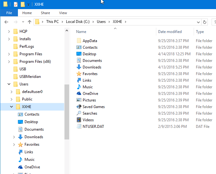

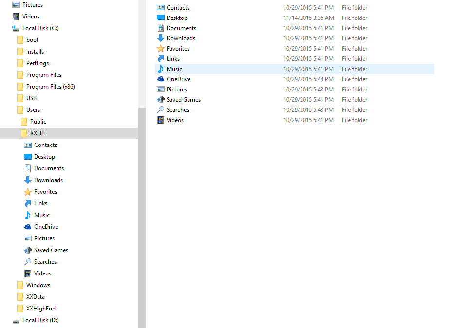

« Reply #2 on: July 29, 2018, 12:17:14 pm »
Thanks Peter. The AppData folder doesn't show up in my explorer, so I'm not able to get to the Temp folder described as a possible culprit. See picture below. This screen shot was taken in base/full OS.
Also didn't find any files that were too large in my XXHE folder.

« Reply #3 on: July 29, 2018, 02:01:22 pm »
It took me 10 minutes to find it again mysef.
First off, in the bar near the top, make sure that hidden items are visible (this is a checkbox - working upon everything, not only the current folder).
Now look below how you only see it sit in the right hand pane ...
Now double click that and only then you can see it in the left hand pane as well (could be a W10 quirck).
This still doesn't tell you have a lot of rubbish in there (mind is still clean after I deleted all in there, several months ago by now).
Helps ?
PS: Take care that you select the path step by step as you see it in the URL in the top.
