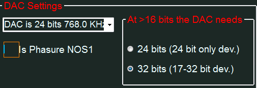

With changing the 24 bit / 32 bit setting you may see some success suddenly more success (see screenshot below, the DAC Needs section).
