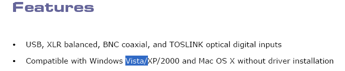

« Reply #8 on: March 15, 2008, 03:03:18 pm »
First of all you will have seen this : Re: Benchmark DAC1 USB;
Note that the 24 bit stuff is all in there by now, so that is not it.
The Benchmark is advertised to be compatible with Vista. I think : it is not, and I estimate it is caused by this :
AFAIK the Benchmark uses a special application of the legacy (MS) USB driver. It think it is even advertised that it can do 24/96 over USB without needing a special driver which normally is the case. Mind you, they say.
I think (!!) I read somewhere the other day that they applied a synchronous application, which is not the most usual. I won't say that by this means they avoided a difficult signed driver route (if that would go through at all), but anyway it doesn't work under Vista WASAPI Exclusive Mode, which IMHO is logic.
Besides that I can be off in my perception on matters, it is not up to me to decide (or know) whether indeed this is related to "not Vista compatibe" or Vista WASAPI not being compatible to MS itself. I think we all know how many problems I have with it myself and on which topics I can point out that Vista flaws on this matter. But then again, I think it is just logic that this won't work.
You can point a Benchmark technician to here if you want.
Sorry.
