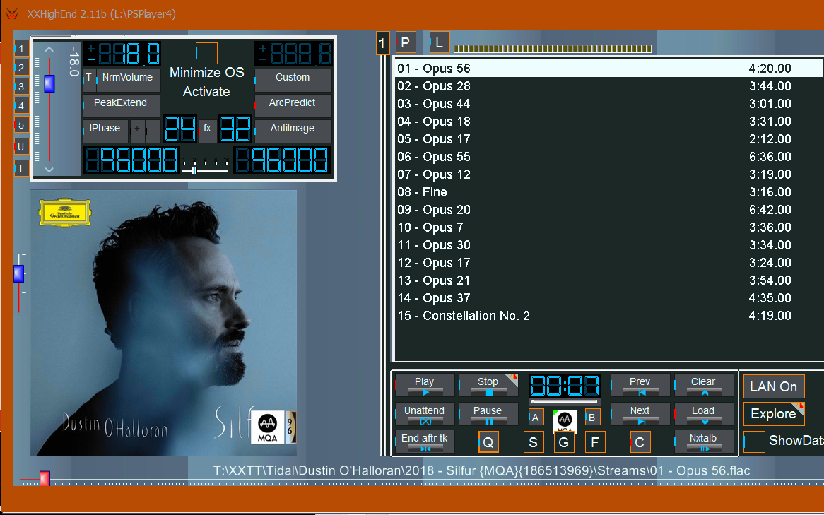

« Reply #4 on: June 14, 2021, 06:11:55 pm »
David,
This shows as normal as can be with my current version here (2.11b, due 2.12).
First screenshot is how it shows after search (with the link you gave). Second is with playing a track (no explicit Prepare, but that won't matter).
I noticed that one album with a blank, white MQA label
Do you mean nothing like the "96" shows ? just blank, that little area ? If that is so, XXHighEnd could not hand the album to the decoder for some specifics which is caused by some authorization problem. But, it should give a message about that. This could be the message "this only impacts the Coverart Icon" or something similar.
If we can not get hold of this specific issue, then we better wait until I uploaded 2.12. But I don't think it can make a difference regarding this specific issue. However, notice that your rights over there (USA) can be different from mine here (Netherlands). But ... this should just be Tidal rights and not specifically MQA related.
