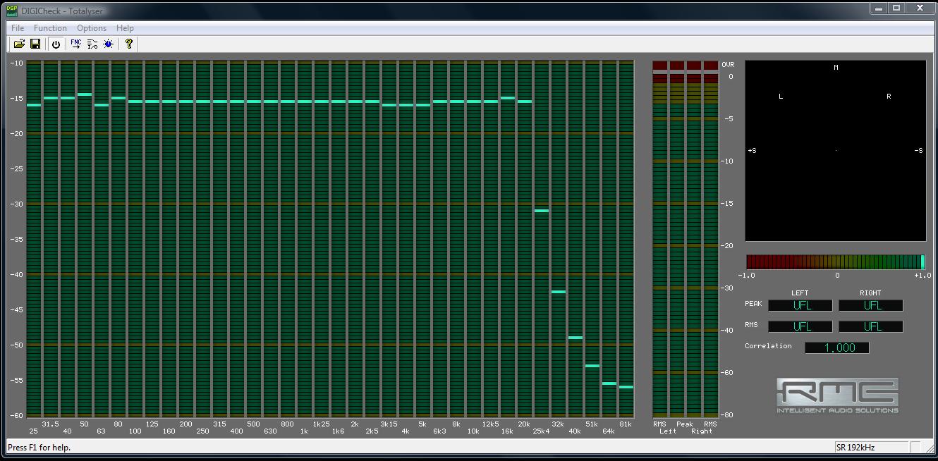

I'm assuming c)
In any event, here are the results with Foobar/ASIO (running 24/192 shared mode). There is obviously an AA filter being applied.

Thank you for the Foobar test Mani.
Now I wonder what happens at double/upsampling with "DAC is" at a 16 bit setting. If this looks normal, then
1. It is most probably the SPDIF limit;
2. Foobar (SRC or whatever it is you were using) doesn't utilize the bits (only uprates the sample frequency).
Btw, I am not asking you to try this, but can't do it myself at this moment (tonight I can).
Oh, when things still don't look normal, I'd try ADAT instead of SPDIF. Happy
PS: I was Googling for an hour or so on the SPDIF matter, but couldn't find a clear answer. Keep in mind that "we" are using SPDIF over Firewire (400 in my case) and that things may matter there.
PPS: I got the idea here : http://www.avsforum.com/avs-vb/showpost.php?p=13353422&postcount=897 which was singing in my head the whole day because I couldn't believe that, while on the other hand, that (MS) guy should know. Suddenly the combination with our topic here popped into my head ...
« Reply #19 on: March 12, 2008, 02:13:42 pm »
It's my lunch break, so I can do this quickly... with pleasure.
Find below the two curves. Just be aware that I'm using my system 2) at the moment - i.e. no external dac and no spdif.
I have no idea what Foobar's SRC does with the bit depth, though in shared mode, Vista pads it to 24 bits, no? (I have it set to 24/192).
* 20Hz to 20KHz double upsample DAC is 16 bit 192KHz.jpg (164.36 KB, 1260x654 - viewed 1013 times.)
* 20Hz to 20KHz quad upsample DAC is 16 bit 192KHz.jpg (171.5 KB, 1328x648 - viewed 1020 times.)
