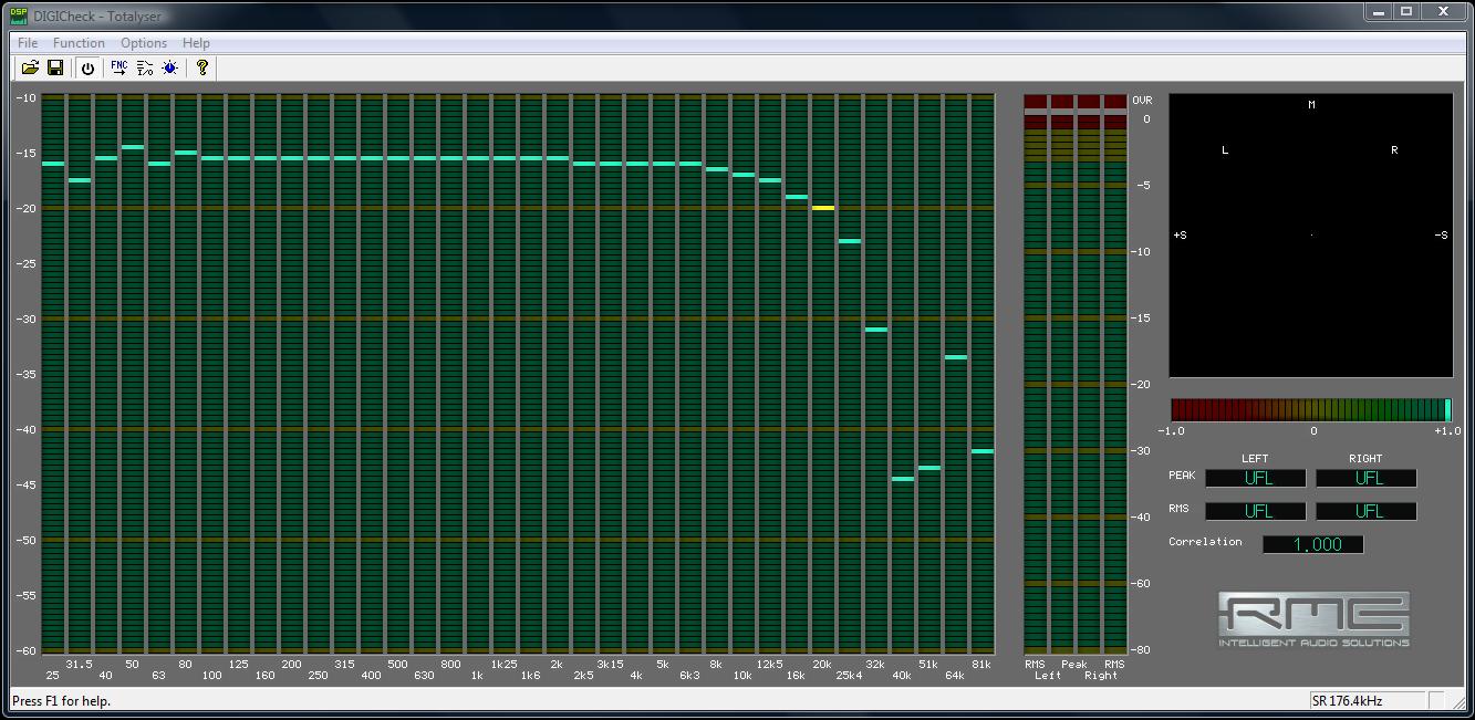

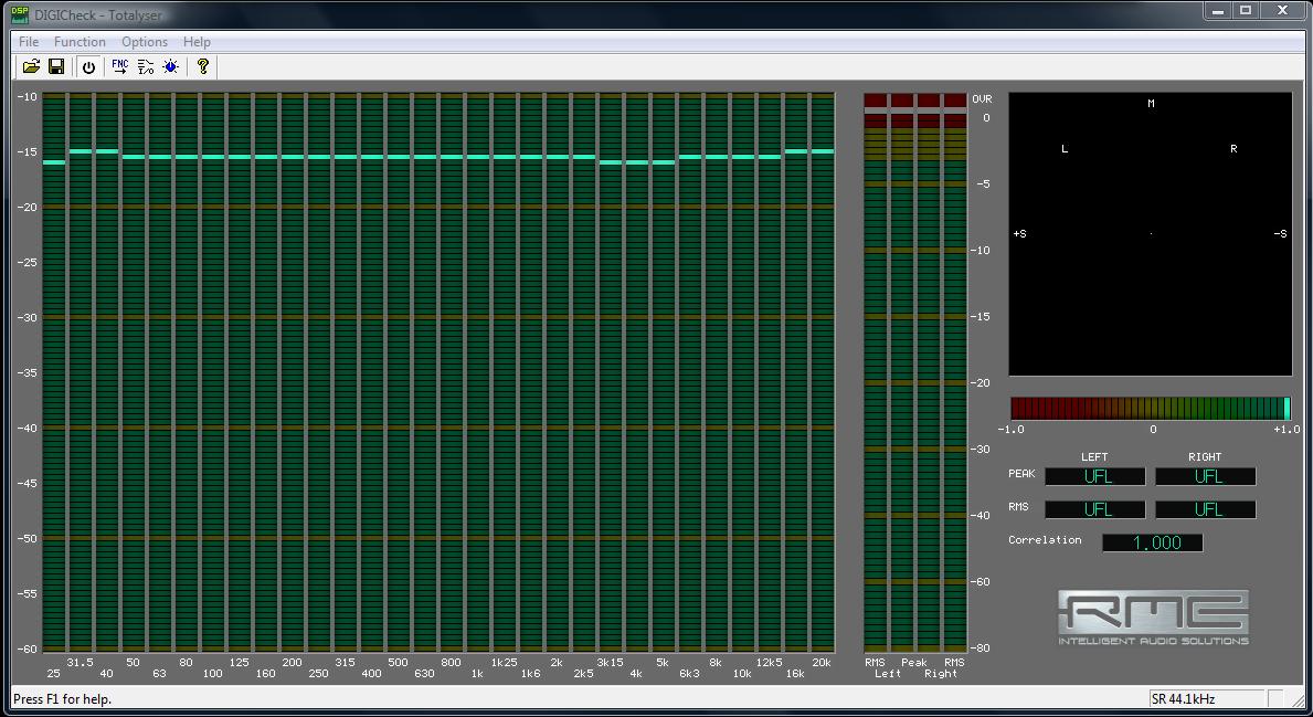

Now, objectlively, I have even more issues with it. As I've mentioned before, aliasing has a definite effect below 22.05KHz.
Sorry, but I couldn't help myself - have a look at the following graphs.
Would love to hear your subjective views on the sound though - please feel free to tear me down.

For those of you not familiar with aliasing, any signal above 22.05KHz is not 'real'. There is no information above this frequency (known as the Nyquist frequency) on a 'red book' CD.
Any signal above 22.05KHz is simply a mirror reflection of the signal below 22.05KHz. The problem is that it tends to interfere with the signal below 22.05KHz, if an anti-aliasing (AA) filter is not used. This leads, in my opinion, to a 'laid-back' though very pleasant sound.
Don't get me wrong, there are some very good reasons why you would want to avoid using an AA, but ultimately, it's all a trade-off.
IMO, the only real solution is getting hold of some high-resolution files... though with XXHighEnd sounding so good set to 16/44.1, I'm not sure if I'm going to bother for a while Happy

The genios are perfect with 0.9u-6 - the correlation remains at +1.0 througout... as it should Happy
Upsampling/aliasing has no effect. And of course, it shouldn't - aliasing won't introduce any phase differences between L and R channels... just within each channel and hence the interference above 5KHz or so.
You know, this discussion reminds me soooo much of a discussion I used to have with a 'hi-fi nutter' friend of mine. He has the full monty dCS digital rig. I used to have a Sony SCD-1 and Marantz SA-1 - I jumped on the SACD/DSD band-wagon as soon as I saw it.
But DSD never seemed to be right to me in the top end. So much like I'm hearing here with upsampling (especially quad). You probably all know that DSD has less resolution than CD above 8KHz. What do you think that does to transient edges... even of something like a bass guitar?
And here, quad upsampling (without AA) is down some 6-7 dB at 20 Khz...
