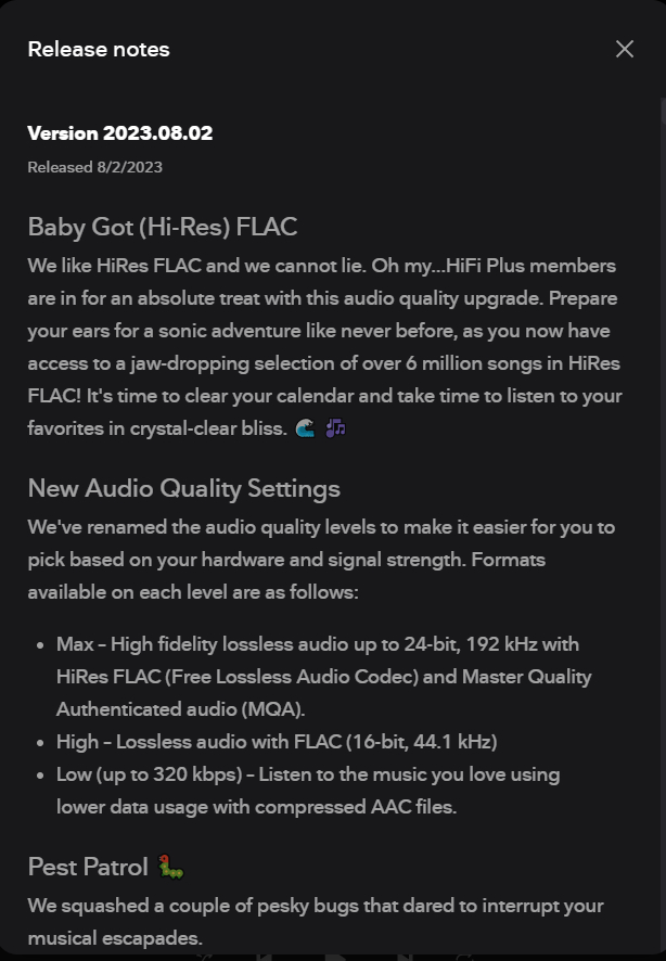

Tidal's Apps now include HiRes offerings, see attachment
Hires files are identified by a Max icon and these include MQA. Unless you measure output or have a DAC displaying Sample Rate you won't know exactly what you are getting.

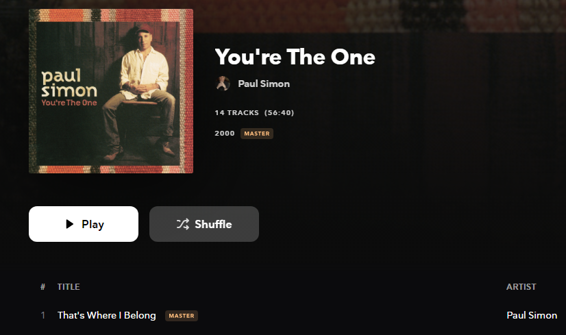

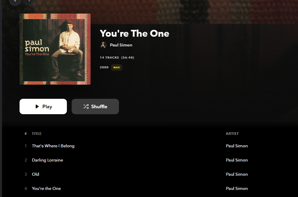

Paul Simon/Your the One might tell you something.
Via Tidal App its Max & plays at 96KHz with & without MQA pass through so probably genuine HiRes (sounds great) Tidal #4157739.
Via Volumio it plays at 48/24 and marked as MQA (no decoding possible with volumio)
My download from XXHE from years ago also Tidal#4157739 is 44/24 and confirmes as MQA using the MqaTagRestorer.
Colin

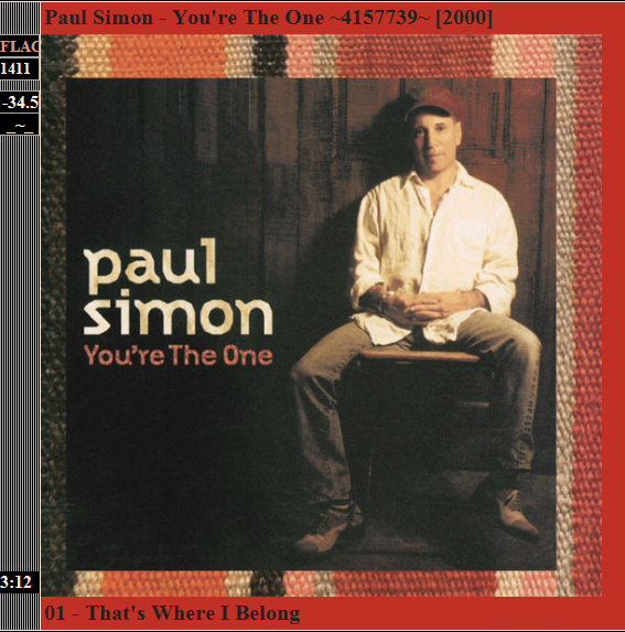

« Reply #5 on: August 16, 2023, 01:06:10 pm »
Hey Colin,
Great thanks - I can work with that.
But bad news - as expected ...
It is 16/44.1 or IOW, the stupid MQA stuff (not even the "good" stuff, because 16 bits).
Internally it is denoted "HiRes" opposed to "Lossless" (smart move) and it readily explains why I deemed many albums flawed-sounding - this will sound bad as well (because molested Hires and nothing is done to it by XXHighEnd now (MQA decoding is disengaged per new download means).
Of course this depends on your info, although I can of course check that myself too. Wait ...
Hmm ... that says Master, so where did you find Max ? I verified the ID :
https://tidal.com/browse/album/4157739
hahahahahaha, bunch of stupid ***sholes. Look below;
So my Tidal player proposed an update and after that voilá, the Master denotation changed to Max.
As a bonus, the last picture shows nothing next to the albums while prior to the update more than half showed "Master" next to them.

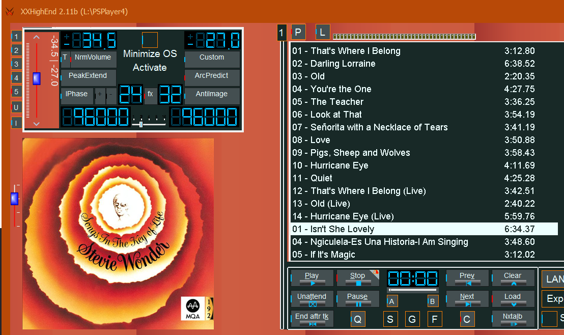

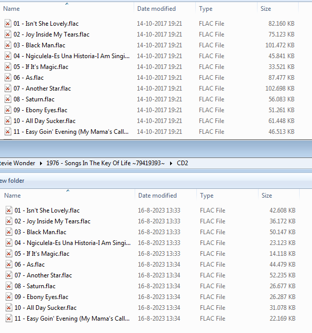

First a conclusion of what's below, because I don't think I knew this : it should be so that the Tidal MQA presentation always was done on the fly. Read : during the playback (download if you will) the album is processed and turned into MQA. This should be derived from the "fact" that the Album ID stayed the same (see below) while today no 24 bit file comes from it. You will believe me when I say that the bottom version was denoted Max.
It may be less easy to grasp that the original MQA album was 24/96, but see below to proved that (2nd picture).
So one hour or so further and I have not been able to find even one album that would be Hires, so what remains is the proof that the Tidal app plays them as Hires. So let's see how we do that ...
Well, no clue. I guess this starts with not being able to play anyway because of (a Tidal message) "There's a network issue - unable to play".
Oh well.
An intermittent other conclusion seems to be that with the one album showing Max and the other showing nothing (= "Lossless") both are always 16/44.1 for those cases I examined and this includes existing ones on my HDD which are 24/48 at the file level. I have no clue / hint about whether these albums now are album-originals (CD's) or that now all flaws over at Tidal's and that Album ID's have been mixed up or what not.
If someone is able to verify the playback rate of the Stevie Wonder album (see in the first picture below) by Tidal app means, please don't hesitate. This should not be done by something like Roon, because that will upsample by default, once it detects MQA (and that tag sure is still in there - it now implies the Max tag).

Hey George, thank you !

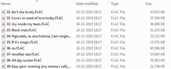

For others : what you see below I still had on-screen, so yes, indeed that.
... But I may miss the point of what you are trying to bring across ...
In any event the files as how they will be on your HDD do not contain the data to "be" HiRes. Look at the files sizes in my previous post. The top part of the two lists is close to twice the size of the bottom part; the bottom part is just 16/44.1 (the top part 24/48).
For more reference below a screenshot of a "local" genuine album in FLAC with slightly worse FLAC compression.
So, despite of what you wanted to bring across, I see that the Tidal app upsamples just as the MQA prescription has been (thus not only for Roon and Hardware, but also for the Tidal app itself).
We are all hoaxed, and it is my estimate that some pay extra for that as well (my subscription still costs 19,99 for "Hires").

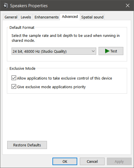

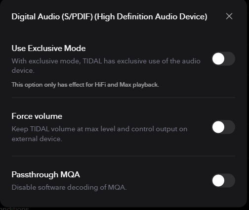

The data I published in this post was misleading.
The Tidal PC App with Exclusive Mode OFF plays at whatever sample rate is set as Default in Windows Audio Device settings (ie Windows does the sample rate conversion) see attached. Therefore Sample Rates from Tidal App will only mean something With Exclusive Mode ON.
Will re publish my album sample rate data in a new post.
