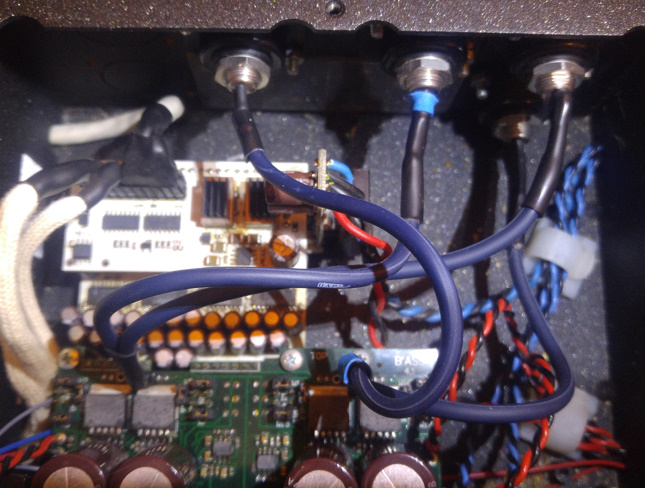

« Reply #6 on: September 09, 2024, 03:13:16 am »
Ok image of my NOS1 parallel wired channels
Should i leave existing wiring on the remaining stereo BNC sockets or should they now be disconnected and protected after swapping in the XLR sockets...

« Reply #8 on: September 09, 2024, 03:55:20 am »
Change output impedance and output voltage will not change, but current will change.  Do you need more current from the NOS1a?  Nope, not into the Orelos nor into just about every preamp or amplifier on the planet.
