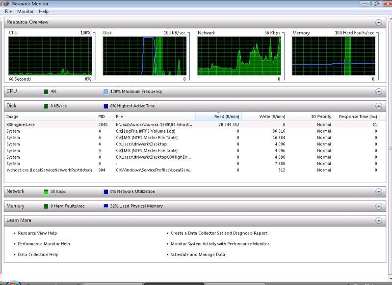

When useing XX: I never load only 1 track. Normally I load an album and play some tracks, or all the tracks in a row. Eventully I load a readymade playlist of 10-20 songs taken from various albums. This is probably common use also by you. If such a playlist has been in use, it seems that the "pre-processing" of those songs is present even if XX is turned off/on. To completely remove them I have to reboot the PC. This is necessary if I am testing the VISTA performance with different settings to get rid of ticks and scratch noises. At least this is what it seems like when watching Task Manager > Resource Monitor. Peter: Is it so?
Observation 5:
Beacuse of Observation 1, trying to find a solution is like shooting on a moving target. For example today I switched on my PC and started playing with old settings (see signature). A lot of ticks and scratches. Unlistenable. After 3 hours, and several changes of settings (se photo) it now works perfect (for the last 30 minutes at least). Going back to old settings (right now while typeing) it's 98% perfect, with only couple random ticks each track.

Picture: Resource Monitor in Task Manager. TIPS: Clicking on the green DISK graph, opens the DISK log, where you can study OS files running. Disk use is in blue colour. When the blue graph goes max, that is when ticks and noises MAY appear. They did yesterday, but not today...
