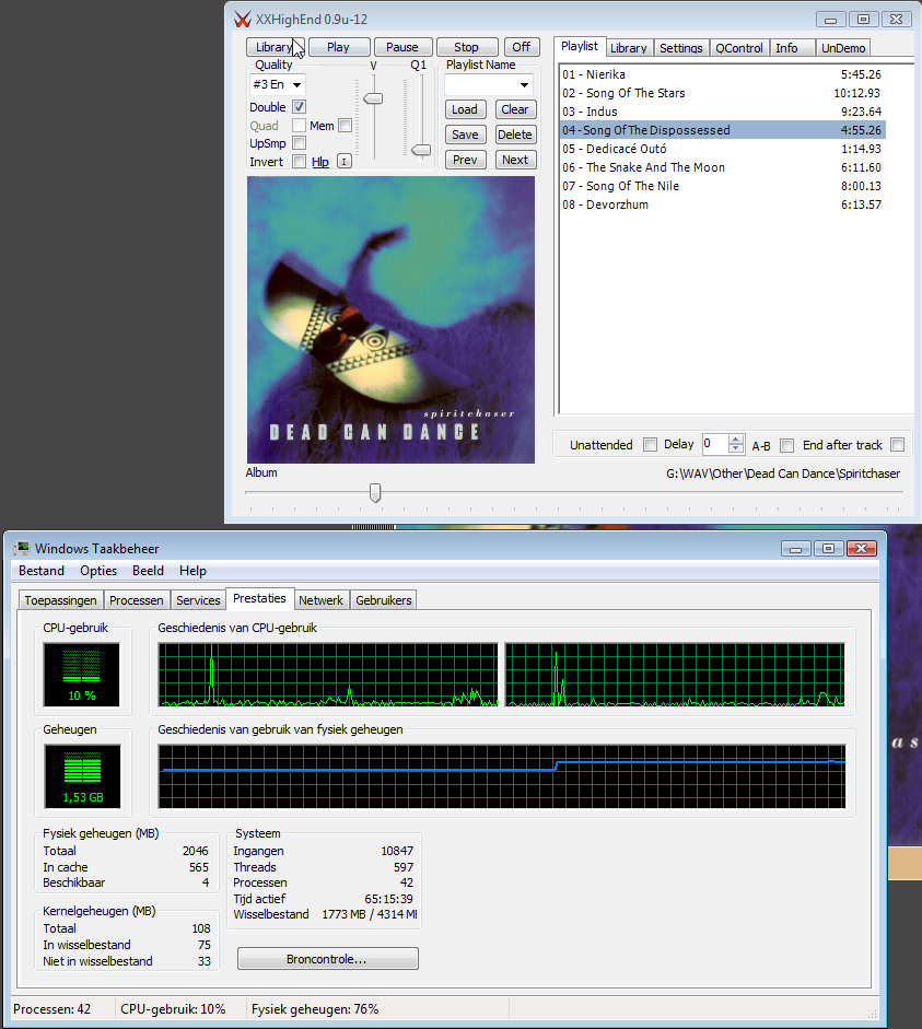

OK Peter, the album I'm playing with is "Spiritchaser" (from Dead Can Dance). I played after a fresh boot, and the same thing happened as before (and in the same spot - so it must not be all that random). Here's what happened:
I started with track 2 and there was a hiccup between 3 & 4 as well as a click - I stopped there.
Then I started with track 3 and there was a click between 4 & 5 and every song after that, and I didn't have a hiccup until between 6 & 7.
Sounds random right? Well, the hiccup seems to be happening at the point when the Memory usage for XXEngine3.exe gets to around 1GB. And the click just seems to happen after the second track and then continues. FWIW, If I start with track 4, then there is no click/hiccup between 4 & 5.
April 19, 2008
« Reply #10 on: April 07, 2008, 10:44:23 am »
Well, at least I have that album !
I started at 2 (Attended), moved the slider towards the end, and had a hicup. Whether that went along with a click I can't tell.
Repeating that wasn't possible, which should lead to the disk access doing it (a second attempt not needing the disk anymore because all is in cache).
Sadly, playing the remainder of the album didn't cause any hicups or anything.
I used the settings from your sig, but Core Appointment Scheme 3.

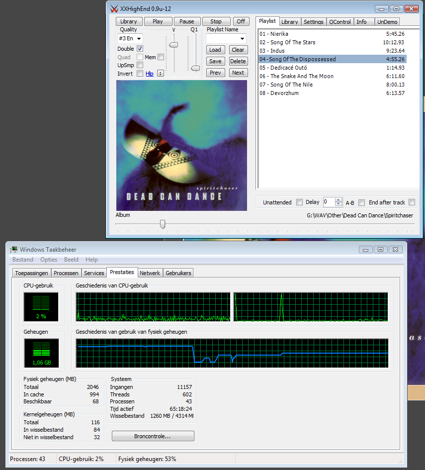

Somehow in here is the crux. I now think of the combination with your earlier observation : the memory not being freed at the first couple of tracks. To too, usually is not repeatable. I have been watching this closely since then, and it occurred to me that I am now able to free "fixed" Vista memory, which otherwise won't go. Just overrun the memory (by much consuming tracks), and from then on my Vista uses in the 300 range (which otherwise would be 600).
Ha ! During typing of the above I restarted at the end of 2, let run 3, and 4 began with a click !
Now, indeed (or coincidentally ?) XXEngine3 used 1.1GB of memory (you can't see that in below DCD01 but I checked).
Next this happened (and this too is one which keeps on puzzling me) : I restarted near the end of 3, 4 loaded, the cursor moved, but no sound. This is the occasion that Engine3 just runs, but it beats me where it hangs out (in the code). FWIW this is DCD02 (say, for my own reference).
Then I again repeated this, and then it played without click.
Ok, and this time during typing of the above, from 4 to 5 a click. Total mem usage only just over 1GB.
From 5 to 6 the same (ver small tick).
Well, I have the example ... Happy
Thanks again for your efforts Edward.
Edit : Since I have these subsequent pictures, there's also something visible that I kind of expected : The heading "wisselbestand" meaning swapfile, shows a decrease of 500MB between the first and thye second picture. I expected something like this because we may expect that when the OS manipulates the swap file it gets all the priority there is. Note though that this never will skip coding parts (but the hicup skips sound) because otherwise we will get one big mess (wrong byte order). So what might happen is :
a. The OS thinks more memory is needed than available (might just be true btw);
b. it moves something over to the swap file.
c. This is logic, because at hicup time as I've seen it, there's more IO going on than expected (by me).
d. This is not the best thing in general.
Now, during the playback of 7 the following happened :
The memory had gone up to 1.74GB.
At the move to 8 it went down to 0.96GB.
Playback stopped and even XXHighEnd stopped (cursor stayed at the beginning).
I quickly made a screenshot when 8 was still playing but forgot to save at making a next screenshot of the 9 situation, at which I found that I didn't save the previous one, and then didn't save *that* one. fool
PS: Bueatiful dry drums in that 3rd track, don't you think ?
