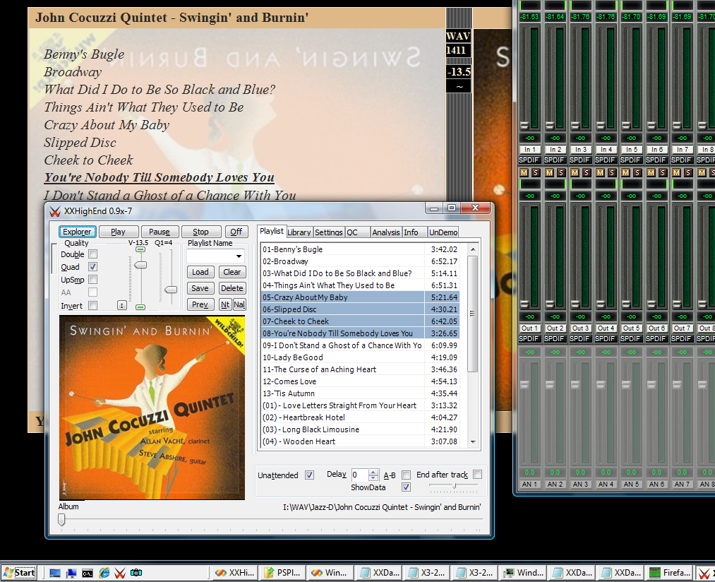

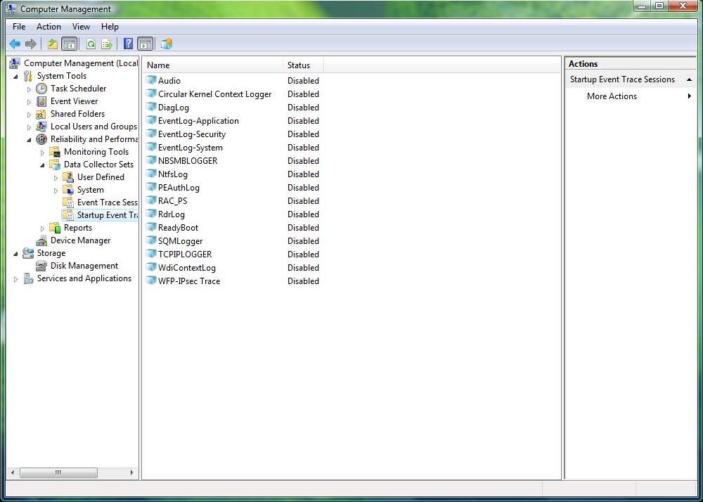

Oke, all off
Things slow down a bit at boot-up, think thats because of the readyboot
Don't know if it really does anything for SQ
but it can be turned of
Pic is after reboot
I'am not sure of those 3 eventlogs, maybe getting some blue-screens when not enabled

« Reply #46 on: June 18, 2009, 05:27:38 pm »
But Roy ... Are you actually looking what the difference is (see picture in the first post, "Disk" ("Schijf"))
If not, you may be hunting ghosts which are not there ...
If that monitor doesn't show activity, there just isn't. No reason to shut down more then ...
Also note that there are HUNDREDS of things more to shut down (also in the logging area), but they just don't make any difference at audio playback. I have tested them all ...
Only the 5 entries showing in the second picture of the first post I can't get rid of. So, if you can tell where they come from, everybody would be happy, including me of course.
All the other things have been dealt with, and if you can't shut those down, concentrate on that (I can, you you must be able too).
Keep in mind, hundreds ... (and all a waste of time to shut them down).
« Reply #47 on: June 18, 2009, 05:47:17 pm »
Yes, using the resource monitor.
Lots of things going on there, I know.
Just curious, glad you already did the most
grtz

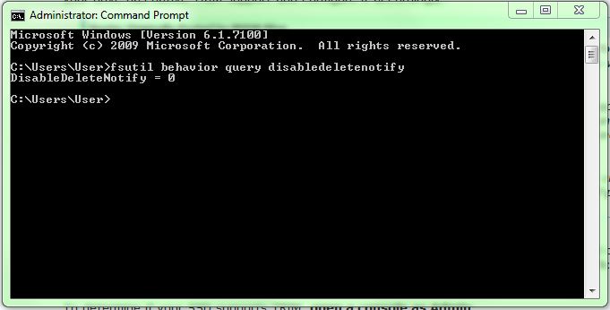

« Reply #53 on: June 30, 2009, 03:45:04 pm »
W7 (Build 7100) on OCZ Vertex - Firmware 1.30:
To determine if your SSD supports TRIM, open a console as Admin;
Code:
fsutil behavior query DisableDeleteNotify
If the console returns a '0', your drive supports TRIM and it is ENABLED.
Source:
http://www.sevenforums.com/hardware-devices/10259-ssd-support-native-w7.html (Telstar read this)

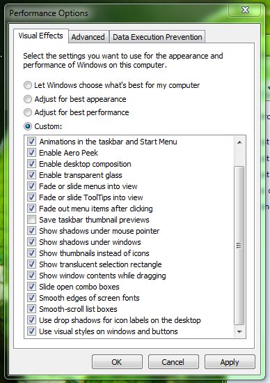

« Reply #58 on: July 30, 2009, 01:16:15 pm »
Does anyone by accident know which service causes the desktop icons to highlight when you click on them ? So, normally when you click (once) an Icon, you can see that you did that (see below first picture, where the right icon is clicked -> no difference with the left one). A service is doing that - which I know because I have it eliminated momentarily (as services can shut down by themselves as wel all know), and I really want to control it myself.
Btw, it will be the same service that makes the Taskbar look like from Windows 311 or so (see second picture), and restoring the normal services as we are used to, won't solve that. Screens just keep on looking VistaAero and all. It must be a sneaky layer somewhere, and I am very sure it benefits SQ when killed (what about no flickering *at all* of the OSD running time eh).
I will probably be able to find it, but if someone knows anyway ...
Thanks !

« Reply #59 on: July 30, 2009, 02:41:53 pm »
maybe you mean this:
Service is "Themes"
"Use visual styles on windows and buttons"
