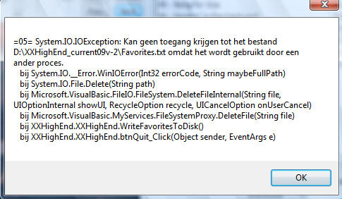

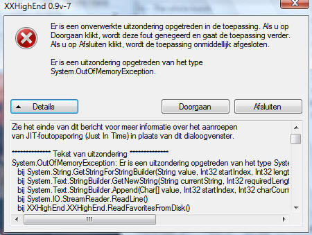

Some days ago after a start of XX i have got the a Memory Exception error. I could not reset this error. After switching XX off i got the next error "System IO Exception. When i start XX again it gives me the first error again. The solution was to install XX in a new folder.

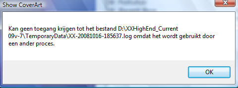

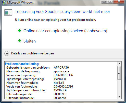

Some days later i have got the spooler error (also in versio 09w-1a) from the past and a show coverart message.

I can't be sure, but the out of memory looks like something being in a loop there, something with that Favorites.txt.
I guess you still have that Favorites.txt in the old XX folder ... would you be so kind to sent me that one ? it almost for sure will help me debug that error.
The spooler error ... I must say, I receive more of that lately again, and yesterday for the first time my GUI was back to windows 3.11. This has been a long time ago, but for me it (very very theoretically) indicates that things have got better once again. Careful though, because that is 0.9w-1(a), where things indeed drastically changed.
your answer.....looks like something being in a loop there, something with that Favorites.txt.
On the Quick Launch bar I always have two or more icons of the different versions of XX for testing purposes. Sometimes I make a mistake instead of stopping one version of XX I'll start another one. The second one can controle the first one, but…… I think that this causes the problem!?!
ah yes ... i have a similar setup and seem to recall on more than one occassion having had 2 instances of XXHE running.
Peter .. would it be possible to put in a check that only one instance of XXHE can run, and perhaps something to cover Johan's issue of cross version control ?
« Reply #4 on: November 17, 2008, 01:06:37 pm »
Nah, there's too much functionality in running two instances, mainly in the area of copying on one, and checking (what to copy etc.) on the other, but also in having setup something in the one (not wanting to destroy that) and checking something else on the other.
Of course you must know that the one who closes down as the last one, saves the -whatever it is- (the first one does too, but it will be overridden by the second (just the last one)).
Of course this should not be done with two different versions ! (when the Data folder is the same).
Whether this impeeds for JohanZ's problem with the Favorites.txt file is something I will investigate.

Some days ago after a start of XX, i have got a Memory Exception error. I could not reset this error. After switching XX off i got the next error "System IO Exception. When i start XX again it gives me the first error again.
Yesterday i had the same errors again. I suppose i start another version of XX during playback of XX. After deleting the Favorites.txt and the XXDat0001.dao files I get rid of the errors and XX works again.
