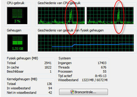

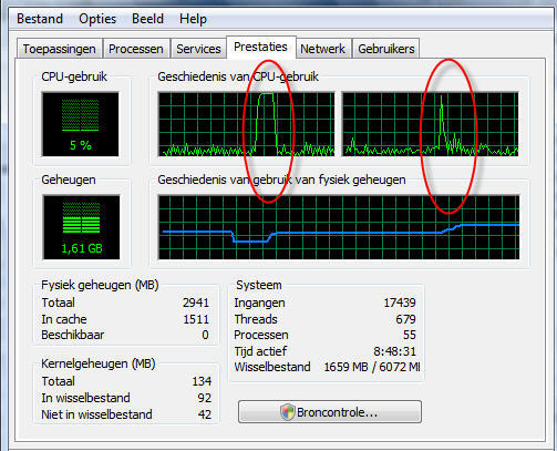

Can you post a graph of it (Performance -> Prestaties) which captures the playing over track boundaries and when you expect gapless while it is not ? Indeed switch "Copy to XX ..." on. I think that will make things very clear to me ...
See attachments

Although the graphs show everything should be within limits, somewhere they are not. But I can't think of where and how.
