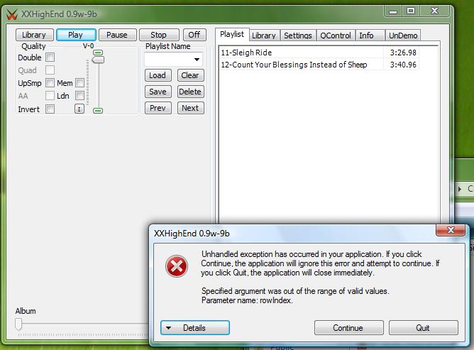

I tried 9b and am getting this error when I drag music files into playlist window and press play:
"Unhandled exception has occurred in your application.  If you click Continue, the application will ignore this error and attempt to continue.  If you click Quit, the application will close immediately.
Specified argument was out of the range of valid values.
Parameter name: rowIndex."
Attached are two files:
1. Screen Shot
2. Log that appeared when I press on the "details" button inbedded in the error msg window.
Kuo-Yao
* msg.txt (4.88 KB - downloaded 535 times.)

« Reply #1 on: January 26, 2009, 08:40:48 am »
Hi Kuo-Yao,
I must be honest : You mentioned a similar error (if not the same) last Saturday; When making the upgrade ready yesterday I thought of this, but I decided to let the upgrade go (instead of waiting another day) because of your other problem, without the solution for this. This seemed more important to me.
I will look into it of course.
Thank you for your patience (and you help on that other problem !).

« Reply #3 on: January 26, 2009, 05:48:59 pm »
I just checked and what happens since I think 0.9w-8(maybe -a) is that it now needs a click on the track first to highlight it. Before this was done automatically.
As far as I can see this only doesn't work (anymore) at dragging files onto the Playlist Area. All the other means are still OK.
Anyway, dragging needs one additional click.
Will be solved in the next version. But if you want I can upload an XXHighEnd.zip right here. You just need to say it ...

KUOYAO
Posts: 33
« Reply #4 on: January 27, 2009, 05:14:36 am »
I'll wait for the next version now that I know that I need to click on a track once to start playing.  Thanks.
