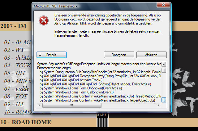

In the period i had the OutOfMemoryException error there was another error called Argument OutOfRange Exception. When i have this error then there is the loop again. XX won't start again without this error.
When you can't get out of the loop, you can try to delete !Played.dat from your XX folder. It can't harm to delete this.
A !CurrentlyPlaying.PLXX could also be a cause. You can delete that too (at emergencies).
Deleting Played.dat and A!Current.....PLXX files solves this error/loop.
What i did:
1 Selecting in the library area the 'd'-button and pick a date from/to
2 Double click in the library area to select an Album
3 Tracks are direct loaded in the playlist
4 Selecting the play button
5 XX plays in unattended mode
6 sometimes i get this error (not allway's and not sure if it is in the last track)
7 Music keeps playing (not shure)
8 XX ends with the Wallpaper and do'nt switched back
9 I cannot start XX again without this error.
I have the idea it is related to the album selection with the 'd'-button. When you close XX this last selection will be memorized by XX. I use this function to play music of a certain period.

Today i had the same error again:
6 The last track is finished
7 In front of the wallpaper i see this error message
8 XX ends with the Wallpaper and don't switched back
10 Stopping XXHighEnd.exe task
11 Deleting Played.dat and A!Current.....PLXX
12 Restart XX
13 Selecting Bugge Wesseltoft again gives another error message
14 Stopping XX and starting XX all works OK
see attachments

« Reply #8 on: February 09, 2009, 07:23:34 pm »
Today same error.
This time a crash on Bobo Stenson (Swedish pianist/composer). When i look at the harddisk in the bobo Stenson directory i find the next file:
x-Reference D{{}}Galeries}}Jazz}}-GalleryAlbum.GLXX where did it came from ???
I think this Argument OutOfRange Error is 'd'-button related.
Next period i will test XX without using the 'd'-button!
* XX-20090209-190659.log (1.12 KB - downloaded 384 times.)

After playing the last track of Bugge Wesseltoft unattended the error is generated. See attachments.
I have the impression that i don't have this error in attended mode.
all testing in 09x-2
