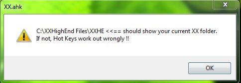

« Reply #39 on: July 24, 2009, 10:03:54 pm »
1 and 2 solved.
Didn't know that, but it can be done in task manager (never used it)
Created new tasks in taskmanager, so @ startup - WinLirc starts, IR-Assistant starts and activates  Grin, XX.ahk starts and ofcourse its possible to
start XX also.
This would be a nice startup. for an audio-pc
Next the xx settings ???
Can you leave this out, maybe

« Reply #41 on: July 25, 2009, 08:13:19 am »
Ok, I think I understand that all. I will focus on it myself and complete things where needed (like that < button).
Why ? because this is another message in the sequence of booting the PC ?
I just leave it on all the time ...
Anyway, I don't think it should go because it just informative. I didn't anticipate on people rebootiong their PC twice a day though ...
« Reply #42 on: July 25, 2009, 09:11:48 am »
Kinda gets old having to "ok" that hotkey message each time I start it up... and ya, sometimes  i reboot more than twice a day hehe.  Can't you put a chk box on it saying "don't show this message again" ... I know how to set up hot keys by now and don't need to see that "warning" each time I start it.
