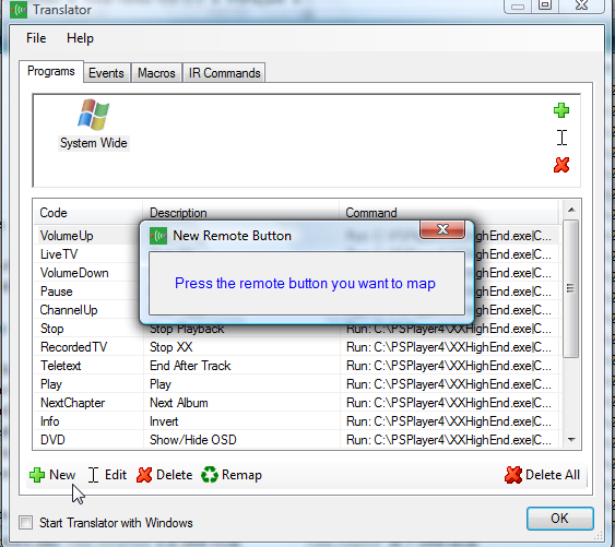

With IR-server I don't know yet what to do with Translator, can you give a screenprint of this?

Yes, I tried HIP first, but that doesn't matter (Update the driver -> automatically, and all is fine again).
See below; while that small screen is waiting, it should receive a keypress from the Remote, if it is working.
