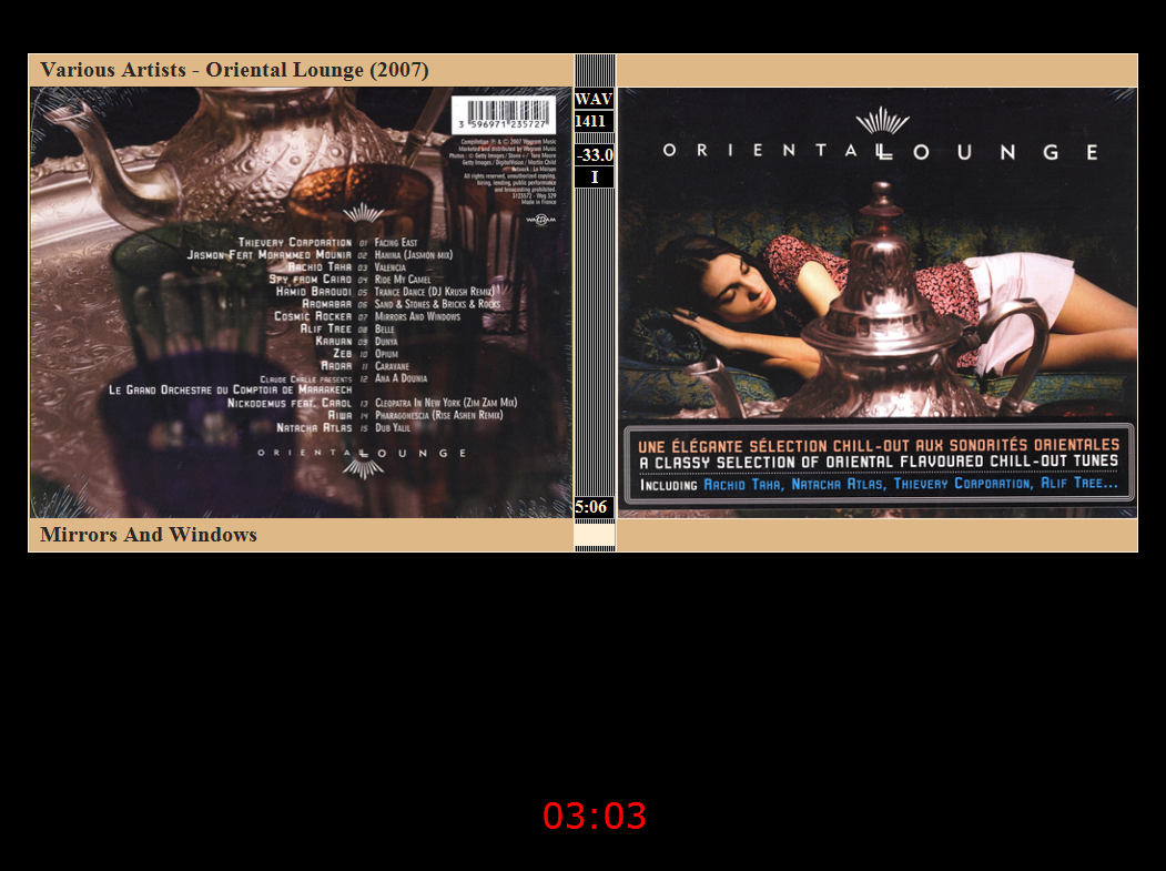

  • Above the "Stop Services" checkbox, there's a new checkbox "Running Time OSD". When ticked, the running time will be "OSD" (On Screen Display) shown (Engine#3 only).
    As many of you early adopters will know, a running time was never allowed because it influences sound. Now, much, much effort was put into letting this not be so. And, jusified, as was found out. That is :
    Assuming that all activities in the PC influence sound (and I think by now we all know that is true), is was found that if the running time was showed "as such", it takes 30-60 times more CPU as how it has been applied now. And, this is even avoiding all "Windows" activities (hence the "OSD" principle) ! This is the exact reason why the services as mentioned above just *has* to be shut down. If not, you're stuck with that 30-60 times more resources used, and SQ will just degrade. Besides, the time it takes to show a next second of the Running Time takes place in complete idle time (and occupies 1/10000 of a cpu second on a 2.4GHz cpu).
    Note that for convenience reasons it *is* allowed to tick the Running Time checkbox without ticking the Stop Services checkbox, but for SQ it realy is no good.
    And on a side note : that SQ just improves by stopping those services, just comes handy. Never mind it is a necessity for the Running Time.
    Note : The running time should display in the area just above the Taskbar, might that be there. However, currently the hight of the Taskbar is a kind of "hard programmed". Might you encounter anomalies to this respect, or might you see a running time which is not on a transparent background (hence a background which is the same as the remainder of the screen), please report ! See below for how it should look like.
