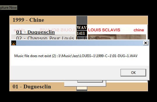

Unattended, switched external disk off after the first sound of the track. Still needs the I: drive. See attachment.

« Reply #17 on: August 12, 2009, 03:17:17 pm »
Never mind. I've already seen it's wrong. Solved in 0.9y-1.

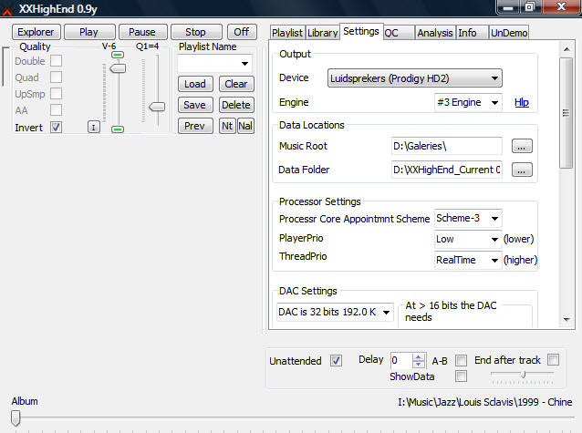

ticked "Copy to XX Drive? "yes"
Upsample? Double? Where are these options?????? After selecting DA setting to 32 bits, these settings are disabled. see attachment
« Reply #19 on: August 12, 2009, 11:31:34 pm »
Hmm ... that never changed. But it is wrong anyway. Solved in 0.9y-1.
Btw, your DAC "is" not 32 bits, but 24.
This is going to be too complicated ...

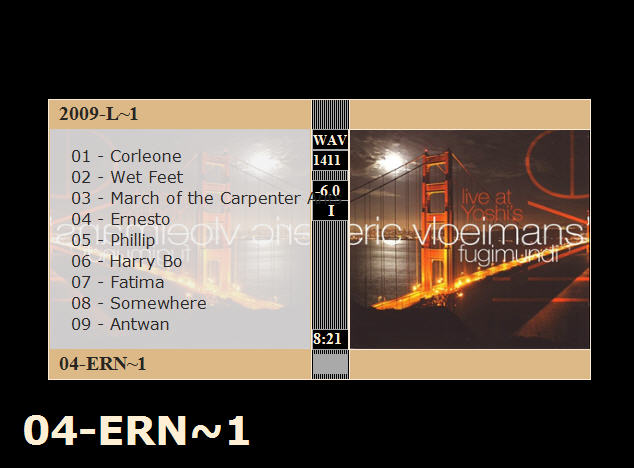

Switching the disks off gives a tilde (~) in the album and track name of the Wallpaper. Switching the disks on solves this tilde (~) problem. See attachment
I have the impression that the disks didn't start every track again...So problem solved....

« Reply #22 on: August 27, 2009, 06:47:43 pm »
Hi Johan,
I still want to look into this, because it smells like it needs the original disk to workout the full path (??). I can't imagine how (for sure not if you say the disks stay calm), but I wonder how it can be that the full path suddenly can't be worked out.
Are you 100% sure the disks don't spin up throughout an album ? If so, I guess I'll leave it to that ...
Don't hurry with this, but when you have any additional info, please let me know.

Unfortunately the problem is still present. During playback i can still hearing the external disk spin up! (Using the settings Copy to XX-Drive (internal drive)) I have the impression that spinup/down sound of the external drive starts after a couple of tracks.
Switching the power off from the external drive after the first track has started in XX, then from the second track to the end i get that tilde problem in the album and track name of the Wallpaper. Music keeps playing. External drives are connected via esata .

« Reply #25 on: September 20, 2009, 12:01:11 pm »
Oh my ...
I actually did solve it the previous time, but the way I did that let show the diacritical marks wrongly. So when I found out about that I applied something like "obtain the full name" and *that* now needed access to the original location (hence spinup the disk). This is why you saw a short Dos name when the disk was not available (plug it out), and which -as I know now- doesn't produce any error message, but just can't work out the short name to a long name, and that's it.
With some creativity I "again" solved it ...(0.9y-4).
