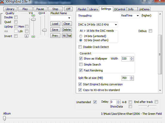

Today i have noticed the spinning up and down sound of the external drives during playback in version 09x-7. I was expecting that all the data was copied to the internal drive! So i decided to do a small test because i have chosen for "Copy to xx-drive by standard". (see settings). After loading a compleet cd and a play command i switched off the external drives. What happed:
1 Music keeps playing
2 in unattended mode, the track titel and indicator stay's on the first track
3 every new track i got an error message. Music keeps playing.
Is this normal behaviour?
Regards, Johan

This doesn't happen for me.  All of my 3 firewire linked external drives with the music files stay off after loading files.  I need to watch how quickly they go to sleep, but it seems to me it must be pretty quick.

Johan,
Can it be that you were playing a Saved Playlist here ? (from the combox box "Playlist Name")
If so, that is the reason. But I guess you don't do that ...
You said this before somewhere, right ?
And XXHighEnd is not installed on that I: drive I guess ? (I know, a stupid question, bit still ...)
This is tough to debug ...
You might post the XX log file from just before the one you already posted (this is the one from bringing it up after playback).
Another thing : First loading the album in the Playlist Area, and then ticking "Copy to XX-Drive" is too late I think.
At fiddling around a bit, you can just look in the X3 log files yourself; when the Data Parameter shows I:\ it is not good. All should point to C:\ or wherever XXHighEnd is running.
« Reply #3 on: April 12, 2009, 10:04:47 am »
I don't use that
Drive D: (internal drive). It has tree partitions c:,d: & e:
    You might post the XX log file ...
See Attachment
This is a default setting for me.
D:/ in my case
It's not so easy to read all those line's. I will give it a try.

« Reply #4 on: April 12, 2009, 10:28:52 am »
  ....when the Data Parameter shows I:\ it is not good. All should point to C:\ or wherever XXHighEnd is running.
Looking in XX3 i see:
20:17:24.2159025 Data Parameter : 0320:DATA:I:\Music\Jazz\STEVEK~1\2006-T~1\02-CON~1.WAV:TIME:8:09.46:BITRATE:1411:TYPE:WAV:START::CV:D:\Galeries\Jazz\STEVEK~1\2006-T~1\folder.jpg:CB::VL:-6:IV:0
????? wacko
« Reply #5 on: April 12, 2009, 10:32:06 am »
Yeah, also the last log file clearly shows I must be doing something wrong. So what you just pointed out is that the CoverArt is ok, but not the music file itself.
Will sort it out !
whistle
« Reply #6 on: April 12, 2009, 10:51:44 am »
I had the impression that the music is ok because it all plays from the internal drive but the coverart needs every track the external drive. When switched off the wallpaper don't get an update anymore...but you are the designer so..
