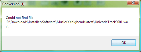

XXHE does not like my new violin concert!
folder: G:\FLAC\CLASSIC\The Romantic Violin Concerto (Hyperion)\Volume 1 - Saint-Saëns
I think is due to the special characters.

« Reply #7 on: May 27, 2009, 12:03:19 pm »
Let me first ask : when you have this (Saint-Saëns could be the example)  is it repeatable ? I mean, will it just be impossible to ever play such a track ?
If so, I recall that the FLAC to WAV conversion can error and no message is shown (while it should). So, it can be the easy problem of wrongly encoded FLAC files !
Also note that this problem will have started the other way around : at FLAC encoding (so, from WAV to FLAC) an error may have occurred, and it needs some special attention of the programmer using FLAC to mention that. In the mean time, the FLAC file is just there, but contains the error, that by itself disallowing decoding.
Note : XXHighEnd itself can create such a situation (IIRC) at mass encoding; an error will show up, but encoding continues, leaving the judgement of what happened to you, and (again IIRC) the ouput file is there. But it is wrong ... (and you should have tried again, throw it away etc.). Whether such a situation is incurred by a bug in the FLAC program or whether it is just a special situation FLAC encoding can't deal with, I don't know. But I myself do have a few files which won't allow FLAC encoding ...

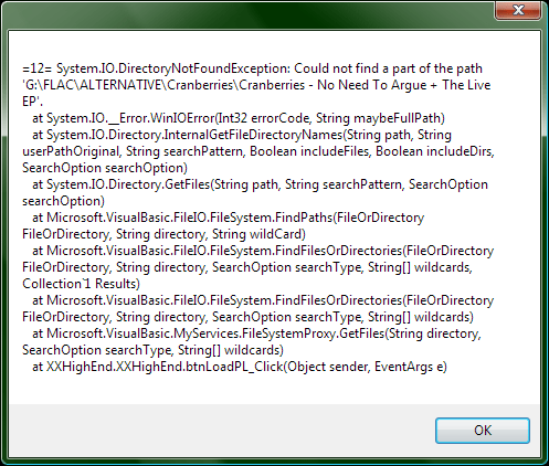

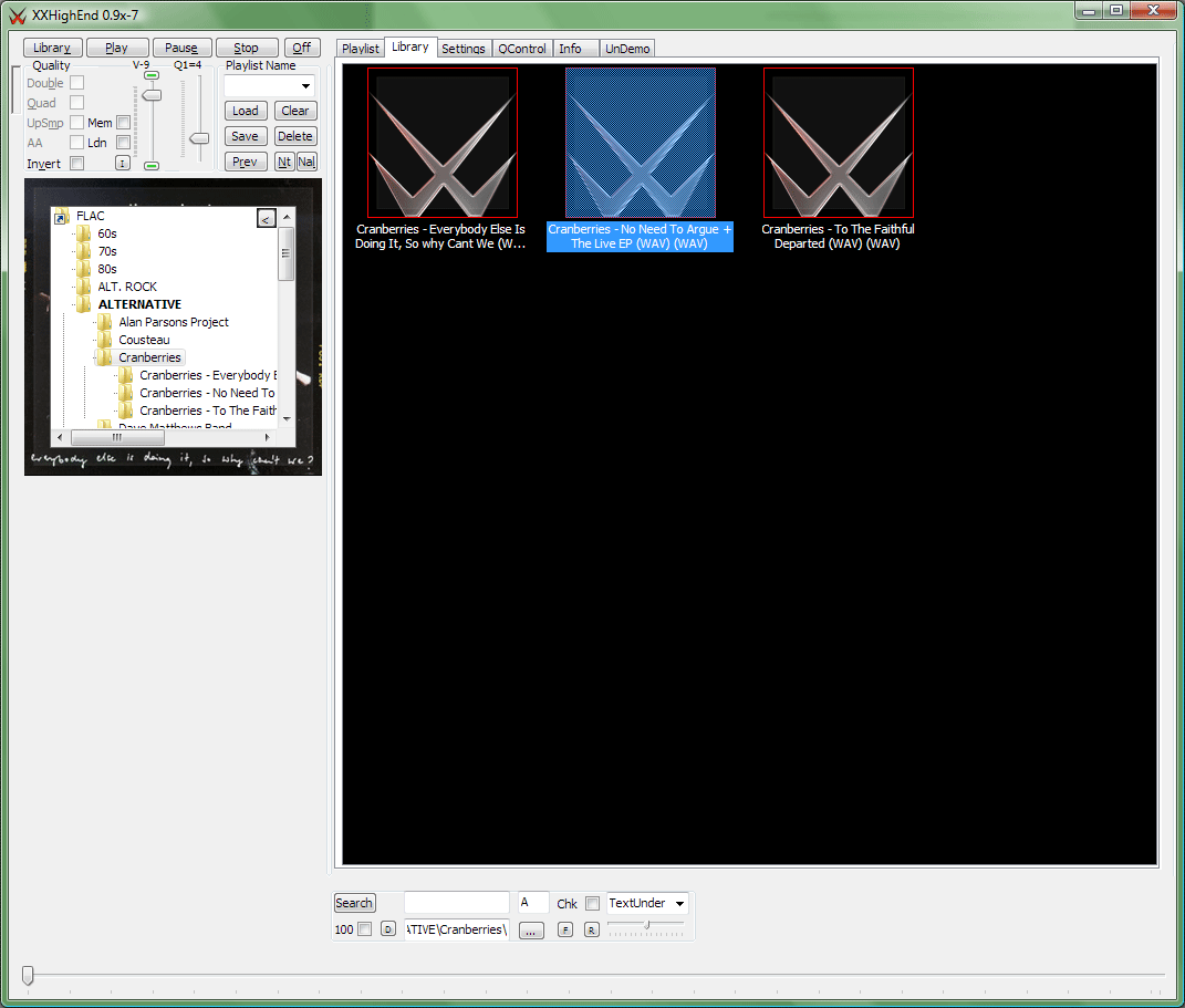

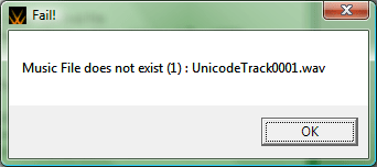

I'm re-organizing my library, which involves moving some folders to another drive.
I have issues with some albums in wav, that xxhe does not like to recognize in the library, and only in the library.
If i drag the single files they are played fine and also the album art is shown (!).
They appear with white text. if i do "show original location"

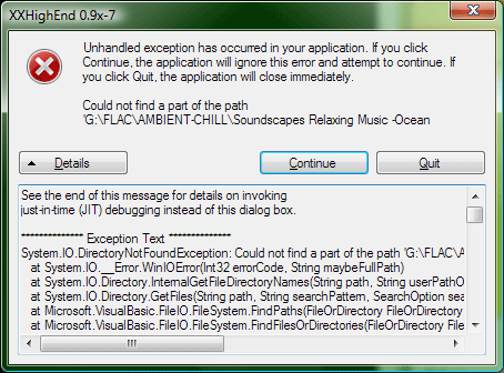

ta-da! unhandled exception (see pic 4c).
if i try to play them (double click), a window error appear, see pic 4 and 4b.
How to fix it?
« Reply #10 on: May 31, 2009, 08:02:08 pm »
Telstar, I'm afraid this is all my fault because I never really finished the Library stuff on this matter (moving / deleting), and in the end the Library entries are still there, but point to non-existing locations by now.
I know this is a pain to get right, but it just is not finished (now you must delete those old Library entries manually ... not difficult by itself of course, but still a pain).

« Reply #12 on: May 31, 2009, 11:48:12 pm »
Depends on what you did. But the worse is when you moved originals to another location. In that case the Galleries created from it earlier should be deleted, and from the originals new Galleries should be generated. The latter is no problem, but when the first is in the middle of a Gallery comprising of other originals as well ... PAIN.
Anyway, the last thing I am telling you is "this is no problem". I am sorry ...
« Reply #13 on: June 01, 2009, 12:37:20 am »
I dont have the "galleries" files anywhere. What if i remove the music folder and let it recreate it?
« Reply #14 on: June 01, 2009, 01:55:53 am »
The Galleries folders are created by XX (on your command) and contain the meta data with .mta files ...
If you didn't (order for Galleries) I misunderstood the whole subject. I will look into it better tomorrow. sleeping
