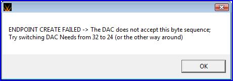

If you receive errors, please show the contents. But, do this for the various common bit depths and rates existing. Example :
DAC Is 16/44.1  DAC Needs 24 Play 16/44.1 file, Error : (and then the contents of the message with a sequence of numbers).
DAC Is 16/44.1  DAC Needs 32 Play 16/44.1 file, Error : (and then the contents of the message with a sequence of numbers).
DAC Is 24/44.1  DAC Needs 24 Play 16/44.1 file, Error : (and then the contents of the message with a sequence of numbers).
DAC Is 24/44.1  DAC Needs 32 Play 16/44.1 file, Error : (and then the contents of the message with a sequence of numbers).
DAC Is 24/96    DAC Needs 24 Play 16/44.1 file, Error : (and then the contents of the message with a sequence of numbers).
DAC Is 24/96    DAC Needs 32 Play 16/44.1 file, Error : (and then the contents of the message with a sequence of numbers).
DAC Is 24/96    DAC Needs 24 Play 16/44.1 file with Double, Error : (and then the contents of the message with a sequence of numbers).
DAC Is 24/96    DAC Needs 32 Play 16/44.1 file with Double, Error : (and then the contents of the message with a sequence of numbers).
The above seems sufficient for me for some conclusions. Of course, when there's no error you will tell that.

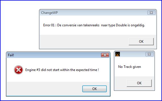

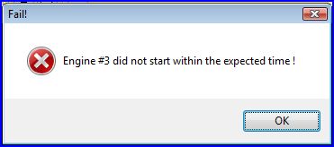

« Reply #8 on: September 10, 2009, 12:17:39 pm »
Okay, first of all here are the error messages I get when trying to set the Dac settings at a higher lever than 16: see clips 1 to 4
the error messages are the same for any setting on a higher bit depth
I get no error messages on 16 bit depth regardless the frequency
I tried the other XXengine3.exe you were mentioning but alas with no difference, so the cracking sounds are still there
I also tried the engine3 exe from version W but that gave error messages as you can see in the combination clip (knipsel5) and wouldn't play at all.
So I've put back the original Engine3.exe (0.9y) to my directory of 0.9y and set the Q1 on 14. In that setting the noise is there just every now and then, iow bearable.
As far as specs concerned for the Xmod, I could not find any details about it either. But I did realize I gave wrong information. The Xmod is connected to a wireless usb audio sender and not connected directly to an usb port. reason for that was that with a direct usb link of the Xmod I got a disturbing high tone (caused by the fan or by the hdd, don't know) and when connected to the SV-1740 R00 there was no noise at all. ............ Still with me??
So my music system is connected with my pc through:
USB port to SV-1740 R00 Digital Audio transmitter via RS 232 to Xmod soundcard to my music system
Hope to have clarified a few things now  Wink wacko
ciao
Leon

« Reply #9 on: September 10, 2009, 01:04:06 pm »
Ok, thanks. Before proceeding :
... which doesn't tell anything about the DAC Needs 32 bit setting (here you used 24 as far as I can see).
