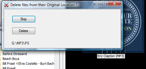

The delete functionality (see picture below) was created to carefully delete physical (original) albums from disk. However, this functionality has not been created for working with "checkboxes" (see "Chk" at the bottom with the Library Area active), but "manages" to call the actual delete function anyway. Some spectacular further coincidences next traverses up the folder structure 2 levels, and right after that the structure concerned is deleted. This happened to Gerard, and of course I am the most sorry about this.
What remains unclear is why Gerard never saw the screen which confirms the deletion, and which is needed to even perform the deletion (see 2nd screen copy below).
On the other hand, since this "Chk" and Delete functionality acted as a loose running train, I always blame me for it.
DON'T USE THIS FUNCTION until it is confirmed it can again (and then still ... yes)

Well, at least that solves a mystery for me. Good - and the most honest that you mention it.
Although that is where that small screen is for (show you what actually is going to be deleted), and while it -thus- did its work as intended, this is clearly not enough; In an earlier (internal) version I had an additional message "sure", but I removed that because after 23 times clicking "sure - Yes" it doesn't do its job. And oh, notice that even the left pane (Embedded Explorer) will have shown what all was about to be deleted. Nice to know afterwards, right ? heat
I will think about something better again, and of course solve this most stupid bug (of the worst kind imagineable smirk).
