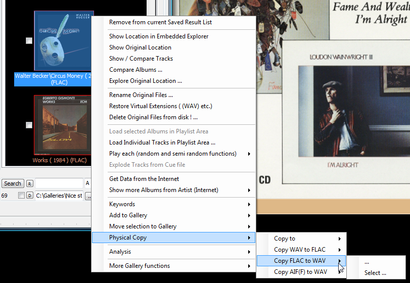

Using XXHighEnd:
Right clicking on a flac file in the library also allows for a permanent conversion of a flac to a wav ... along with a couple other options.  I don't feel a need to do that anymore now that XXHE copies the flacs to wav onto my SSD before loading into memory.
I live life slowly.  No playing before all conversions are done for me.... just push play and slowly walk back to my seat so my martini doesn't spill.
edit
wait, I just tried to copy a flac album to wav, but all it did was copy to flac again?  Is Copy flac to wav not working anymore.

« Reply #5 on: October 05, 2009, 08:51:46 am »
Edit : Somehow I read the below as not knowing where to go. My bad. So the explanation is not really necessary I guess.
I didn't know that you could convert the files by right clicking on them, thanks!
For the conversion from FLAC to WAV, see below. Notice that this starts with rightclick on one of the coverartpictures, and the selection of albums to convert which may go with checkboxes as this shows (I forgot to tick one for "selection") here. So you can do your whole collection in one go if you want, although it may take some days in your situation. Happyswoon
But guys, if your PC is really that slow, it is no good for music playback. This is not related to the 1.4 GHz, but to the (power saving) processor type. There is no good second level cache in there, there is no good task swapping, it is, well, just no good for the best music playback. And it is hugely inconvenient (if things go like this yes). For example, 0.9y-4 contains a new GREAT upsampling algorithm, which is especially (and very very much hopefully !) suitable for your MSB, boleary. Now, although you will be able to use it, you will hardly be able to change the digital volume during playback, because the change will come through 30 seconds or so later (in my case this is already 4-5 seconds which I find doable). If you don't use the digital volume, ok, but you will be holding yourself from all kind of nice stuff because it is too sluggish/slow to use !
I am SURE your best investment would be a desktop, or at least anything with a normal processor in there, preferrably with real dual cores (like a cure2duo which is *not* the same als duocore). Please listen ... sounds good !
