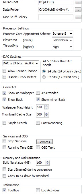

Hi Peter
I have xx09y4 running with engine#3. The problem is that the music "stutters" (ie music plays for 1 sec stops for 1 sec runs for 1 sec and so on) for first 30 secs of a track then settles down and plays continuously. If it is a long track sometimes it stutters for a few seconds in the middle a track. I have checked processes in task manager and I cannot see any other process cutting in (I wondered if another process might me interfering). Checking "relaibility & performance" with xx running seems OK with cpu 39% peaking 83% disk 0% peaking 3% memory 73% (53% xx not running) regardless of whether stuttering or not.
System is HP Pavillion dv9500 laptop, Intel Core Duo, Vista Home Premium SP2, memory 2gig.  Off Ramp to Audio Note DAC2.1.
I am running 2 x upsampling with Arc Prediction (xx running in administrator mode) although the above problems occur regardless whether upsampling or not.
Attached is copy of the settings page.
I hope you can help because the sound quality is amazing (even with Pace Car removed which will only pass 24 96)
Question : I do not understand upsampling. I thought that with a 24/44.1 native file 2x upsampling would change that to 24/88.2 but I must be wrong because off ramp will only pass 24/44.1 24/48 & 24/96 and it works.
Hope you can help I cannot live with 09y4 sound quality now I have heard it.
All the best

Try to set the Player Priority to Low and the Thread Priority to RealTime. Furthermore set the Core Appointment Scheme to 3.
Next tick Stop Services (and Running Time OSD plus OSD Text if you want).
Tick Start Engine3 during conversion to tease things (this makes it worse again !).
Tick Unattended in the main screen (at the bottom).
Click Play and run away. swoon Happy
If all is right this helps and you can go back into the room within that 30 seconds, not being sure whether they have passed already. But, sound will be better again !
If this doesn't help, untick that Start Engine3 during conversion, and try again.
But if it doesn't help, I can't imagine that it is still exactly the same, so please describe the difference in that case.

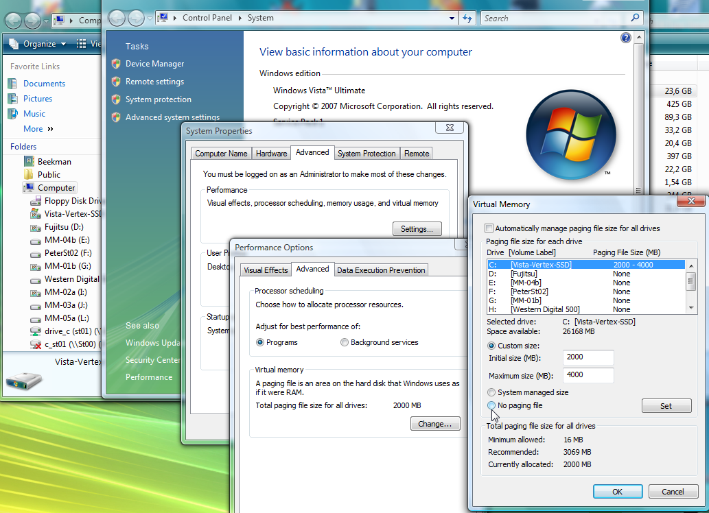

Somehow I have the feeling that your laptop is doing something strange with its memory. Now, for now just keep those settings I advised, and do as follows :
Switch off the virtual memory (swap file) for your OS disk (you probably have one disk in there anyway). This means that when more memory is needed than you actually have, you will receive out of memory errors (don't use Engine#2, which is a different beast and/or problem. So only use Engine#3). With your 100MB Split file setting you should be able to have all in memory easily, and you should not receive an out of memory error. But I suspect you will receive it anyway ...
I base this on a one explanation I can think of about these 30 seconds stuttering, and this is about reorganizing that virtual memory. This has the highest priority of all and just *will* interrupt sound when in order (too heavily). But then the point is, you shouldn't be using it, although it is always used by Vista because it "preloads" stuff in there, without it being necessary. This means that when you run out of memory, Vista has been smart and that that time the memory doesn't need to swap out to the disk because it already has been done. This can just be avoided by shutting it off. Of course this only works when you're not in lack of memory, but again, with these settings "officially" you won't. Or not for this playback anyway. Of course I am not talking about the other things you may do with the laptop, so this is only a test.
When you look at TaskManager, you still may see "virtual memory" in use, no matter it has been shut off. This is because withing the normal physical memory there's *also* virtual memory, and it is exactly there where your "available" memory may be eaten. It differs per processor or OS implementation, and maybe nobody understands how or why. In my case I have 1.3GB available from the 2GB, and only in special cases I can consume the full 2GB. It is my suggestion that in your case you have even less available, and therefore the swapfile comes into play, and *that* bugs your sound, plus it is a typicle thing which may last a longer time (like 30 seconds).
If you don't understand this all, don't try to. Switching off that virtual memory is sufficient to prove I am right (or not).
If you don't receive out of memory errors, of course try whether the problem is solved.
Depending on the results we will proceed from there.
PS: Start Explorer, rightclick on Computer - choose Properties, click Advanced System Settings, click Settings under Performance, click Advanced tab, click Change under Virtual Memory, tick No paging file, click Set

Peter - I switched off page filing and it does not appear to have affected the sound - the stuttering still happens.
