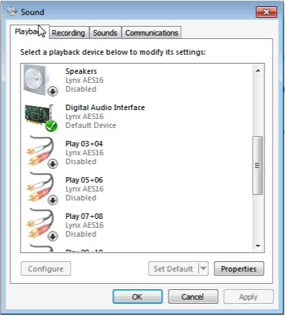

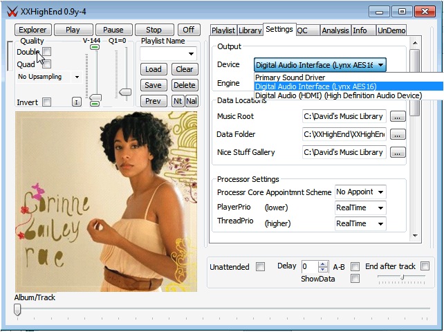

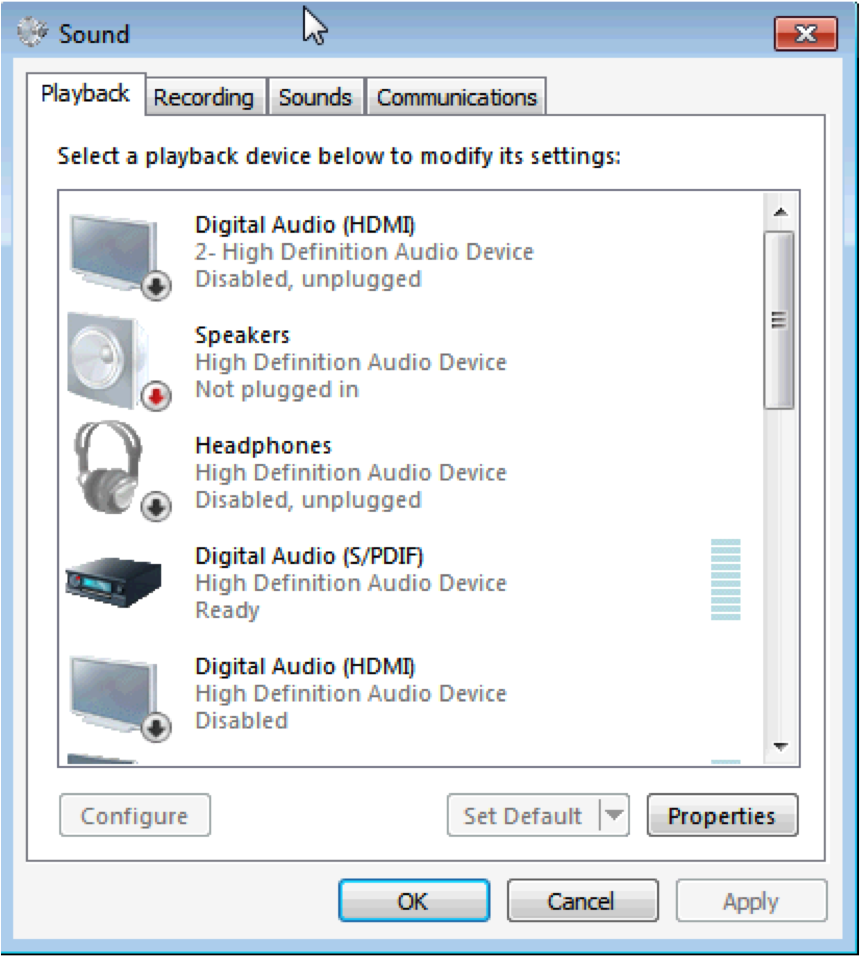

Here are the pictures.....

David - Select the Lynx digital interface, and lick Properties. In there go to the Advanced Tab. There is that drop down list I want to see !

Peter!  I got it working on engine 3!  I ended up trying Play 07+08 (Lynx AES16) and I could see on the Lynx Mixer than I was getting sound....but oddly it was showing up on channel 4....so them since my HD26-to-XLR AES/EBU cable was designed for channel 1 I simply remapped channel 4 to channel 1 and BINGO we got tunes playing!  Sounds great so far!  Got to experiment with the Arc Prediction. Also, my DAC is showing the proper incoming sample rate and the volume control is working for the first time.  Would you recommend using it versus the one in the Berkeley?
The only thing I'm hearing now is intermittently I'm getting crackling sounds on the playback...if I stop or pause and restart it then goes away....I think some other posters noted this as well.
THANKS so much for being so responsive through this process.  Very much appreciated.  We'll have to make sure this intel gets passed on to other Lynx AES16....I'm going to play around some more and see if it works on other settings.
