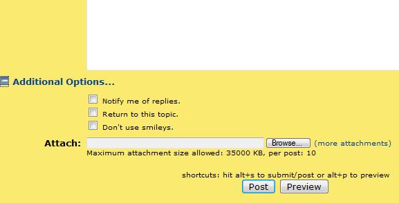

How do you do I copy and paste a dialog box into a post?

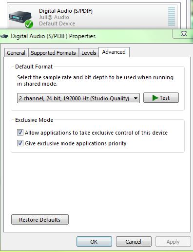

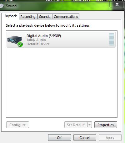

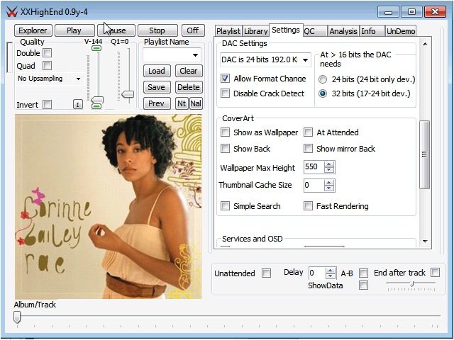

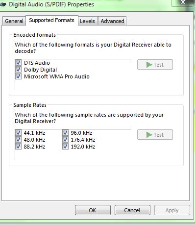

Pic 1 = How to attach pics on forum (use Snipping Tools in W7 to make them very handy tool)
          (Click addittional Options)
Pics 2,3,4 are your soundcard settings (use speaker Icon to get there, Right under on desktop)
See pic2 for Default device, you can disable all others (just Right click and disable)
             ONLY keep SPdif (but make some screen shots first, so we can see whats there)
             (maybe AES ???)
Pic 3 and 4 speak for them selfs
Pic 5 = are XXHE settings
Maybe You already know this, but just to be sure

« Reply #12 on: October 31, 2009, 09:25:38 am »
Look at Roy's 4th picture. There you see the two checkboxes. yes
or anyway mention what is in that drop down list ?
Now, I need to know the contents of that dropdown list !! aggressive

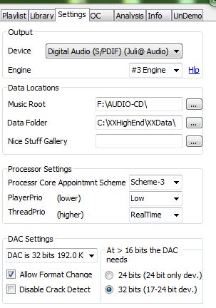

« Reply #14 on: October 31, 2009, 03:25:24 pm »
Peter/Roy, thanks for your continued assistance.
Here are 3 screen captures of my Control Panel Sound manager plus 2 of XXHighEnd Settings.
Note, that I disabled the two HDMI objects, but the problem with engine 3 in XXHighEnd continues.  I also tried disabling the SPDIF object.  The settings for Digital Audio SPDIF are set as per Roy's instructions, but again I still have the issue.
Question....why would the SPDIF object settings even matter since I am not selecting this in the Settings in XXHighEnd?  I'm selecting Digital Audio Interface Lynx AES16.
I look forward to next steps.
Best,
David
