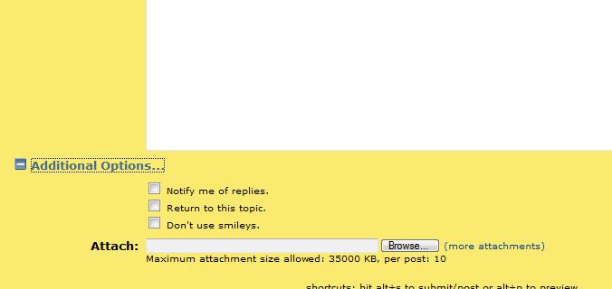

« Reply #36 on: January 13, 2010, 12:37:48 am »
Can someone refresh my recollection of how to post screen shots. Thanks.
« Reply #37 on: January 13, 2010, 12:43:17 am »
or use an image hosting like Imageshack

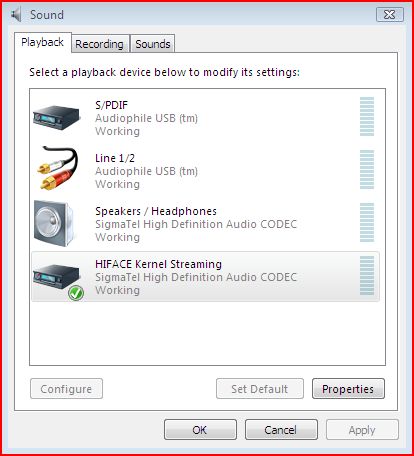

« Reply #38 on: January 13, 2010, 12:59:12 am »
Okay, I changed the name of one of the internal sound devices but I can't get rid of the second line. Is it possible? See below (hopefully):
« Reply #39 on: January 13, 2010, 01:01:22 am »
oops in the last selection of my previous post, HIFACE Kernel Streaming, how do I get rid of the sigma tel stuff?
« Reply #40 on: January 13, 2010, 01:07:15 am »
It isn't necessary !
Did you try it for getting sound out of it ?
And to keep in mind : try both the DAC Needs 24 and 32 settings (and beware of static).
Next play a 16/44.1, no Double or anything (try that once you have sound).
... and of course select that device in XXHighEnd ...
