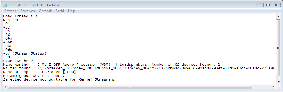

Question just now i had to rename again. It did not remember what i have put in yesterday.... Any idears?
Grtz
That's not the way to win prizes Gerard !
hahaha, but I guess it is in the beginning of this topic ?
E-DSP WAVE [ccoo]
No prices for me....  unhappy I do not understand what you where saying but i have tried it a few time's but everytime i shut down the pc i have to rename again. I also tried the other option *E-MU E-DSP Audio Processor (WDM)*
But that does not result in playback.

No prices for me....  unhappy   I have tried it a few time's but everytime i shut down the pc i have to rename again.
WHAT !!? Well, that would be a nice (W7) bug then !
But ok. I say it again : my solution so far is the most awkward, and the next version won't require that.

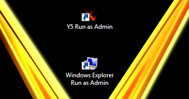

« Reply #73 on: January 15, 2010, 08:20:49 am »
I have too admit that i did not have admin rights.  blush1 After somebody who said his rights where disappeared
i checked overhere and here too they where gone. I don't now for how long and how that could affect some of the troubles i had to deal with.
I like to say that the renaming i did yesterday they where ok this morning. And where i said the music stops playing after 2 tracks yesterday i did not have that. Not even with the same cd. I will keep testing but i had to tell you this. I really don't now if it is related.  unhappy
Ps I have put this on my desktop so i will never forget to check so now and than. Maybe handy for others.  dntknw
Grin
Posts: 16827
« Reply #74 on: January 15, 2010, 09:40:29 am »
Aha, so that is a new one ... But do you mean your (non) admin rights also reflect the saving of the device name ?
Ok, after I upgraded to W7 I had similar (had to set that all again -> could be normal, no problem by itself). But in W7 there is a kind of "bug" when compared to Vista, and that is that the OS doesn't tell you to reboot after the UAC settings have been changed (by you). And then ... then it works "half" and I couldn't make sense out of anything. After a few hours of trying (and indeed getting all sorts of anomalies and inconsistent behavior) I rebooted ... and then all was fine. Btw, I added that immediately in the "Vista prepare ..." topic at the time.
What this all has to do with stopping at the end of a track I don't know BUT if those admin rights prevent you from writing to files (which I can imagine for some types of writing) then this becomes "logic". But, it would be a long shot I guess.
